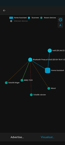

I don’t think I have tried it but as far as I know, ESP 32 proxys are just like built in Bluetooth. So it should work.
If I have time tonight then I can try and boot up my inkbird next to a proxy and see if it connects that route.
It connected through the proxy

Yeah it does - I do not have one, but my HA sees two inkbirds in my neighbourhood via proxies
