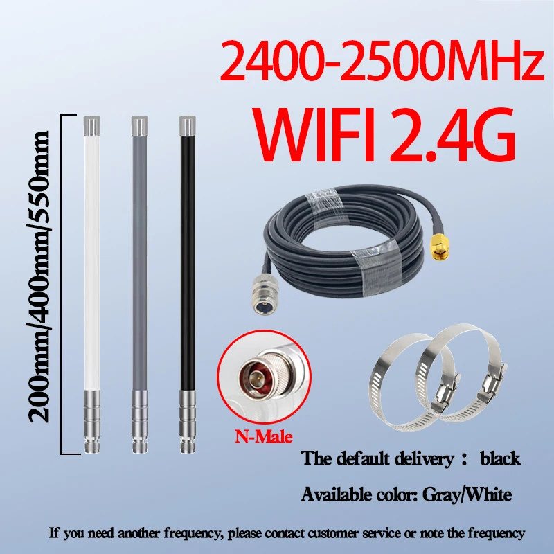

I'm confused as heck here. I have a Sonoff ZBDongle-E (V2 model) which has a bit of a range problem. I need to have that on the third floor, and the Zigbee stuff is on the first floor. I have an IKEA Trådfri range extender right below it on the second floor. I have had problems with a Tuya TS011F_plug_3 loosing connection maybe once a month and needing to be unplugged and replugged to get back on the network. So I bought a larger 2.4gHz antenna, the 55 cm version of this one:
But the LQI actually became lower. I had 236 with the original antenna and now I have 216. Is that in any way, shape or form logical?

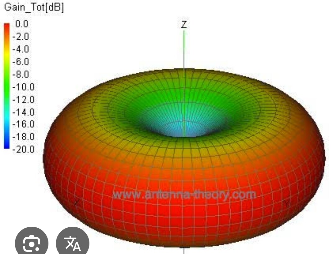

Make sure the antennas are not pointing at each other. They need to be side-on to each other. The radiated signal is strongest that way.
Thanks for answering! But I'm confused. Antennas? There is only one antenna, at the moment the larger one, and before that the smaller, original one.

Sometimes antennas off Aliexpress dont resonate at the correct frequency range. When you buy antennas that claim 5dB gain it generally means laterally at the expense of above you.
All a different antenna cando is stretch the pattern.

At 55cm for 2.4ghz ISM band you could fall foul of EIRP rules.

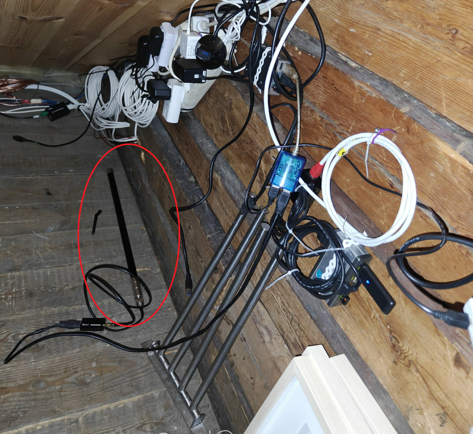

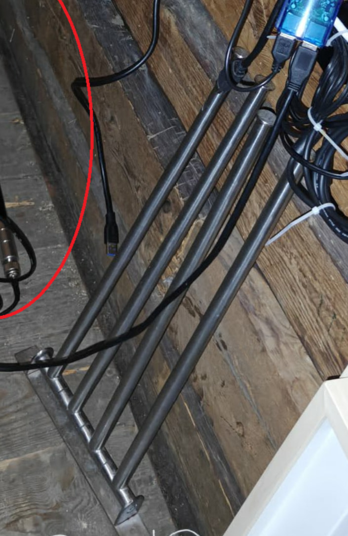

@Spiro I know, that's why I have the antenna laying flat like this, with the "business end" downwards, in the direction of the devices:

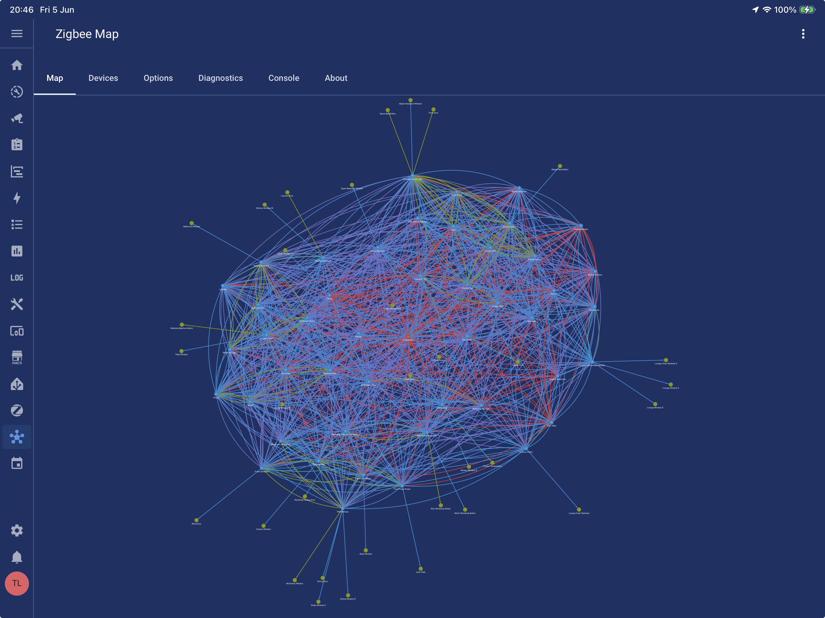

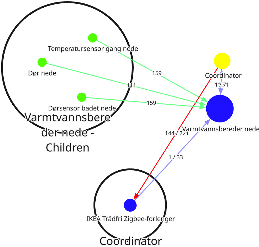

@tom_l Yeah, the problem is I don't need more devices. I have the Trådfri extender/router and the Tuya 16 ampere plug-in switch, both really only to get the lock to work. Here's my network map:
The two other battery powereddevices, the temp sensor and the door sensor, work even if the "Varmtvannsbereder" (water heater 16 amp Tuya) is gone, the lock "Dør nede" does not. No idea why, but it won't work reliably on the IKEA Trådfri, which is exactly in the middle between the coordinator on the second floor and the devices on the ground floor.
Expanding on @tom_l comments. ZigBee routers aren’t really associated with PI devices and most non-battery ZigBee devices will route.
Based on your picture, you are having signal interference issues. Looped cables are an issue!
Yes you do. One router (range extender) is not sufficient.

Regarding your antenna position: i'd place it somewhat furher away from mains cables. Also, i'm not sure that lying at the floor is "ok"... ?

may I ask what is the silver object?
Ammm... towel hanger for a, say, bathroom? :rofl:
Exactly! A towel hanger from IKEA. :grin:
