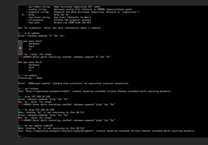

The update seems to have broken my install. I did the backup but on boot it is sending me to the emergency console stating that the client can’t start. :frowning:

Same setup and issue. Proxmox 8.4, 2025.6.1 broke internal communication.
Zigbee2mqtt works, but most integrations are non-responsive. Any calls to download py wheels return that it is not connected to the internet, even though add-ons are communicating fine.
