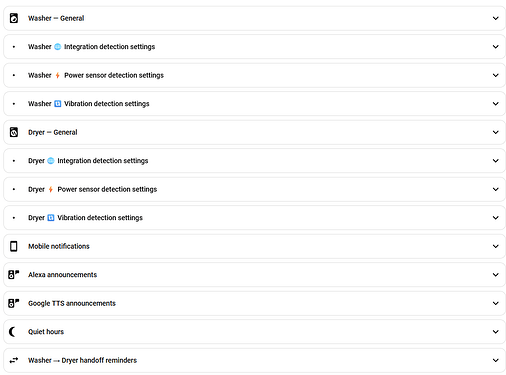

What It Does
One automation handles everything: cycle detection for both machines, notifications across multiple channels, quiet hours, dashboard state, and washer-to-dryer handoff reminders. Enable just a washer, just a dryer, or both. The blueprint adapts to your setup.
  • Three detection methods — power sensor (smart plug), vibration sensor, or a smart appliance integration (LG ThinQ, SmartThings, etc.). Pick the one that matches your hardware for each machine independently.
  • Three notification channels — mobile push, Alexa announcements, and Google TTS. Use any combination.
  • Quiet hours — suppress notifications during sleeping hours with per-channel control. Silence your speakers at night but keep mobile alerts, or suppress everything. Set times manually or use a Schedule helper to share quiet hours across automations.
  • Washer → Dryer handoff reminders — if the washer finishes and the dryer doesn't start within a set time, you get a reminder. Reminders repeat on a configurable interval until the dryer starts or a max count is reached.
  • Dashboard helpers — input_boolean helpers track machine state for dashboard cards and other automations. Optional input_text helpers show messages like "Washer finished at 2:45 PM".
  • One-shot test mode — trigger the automation manually from Developer Tools to test all your notification channels at once. No need to run a real cycle to verify your setup.

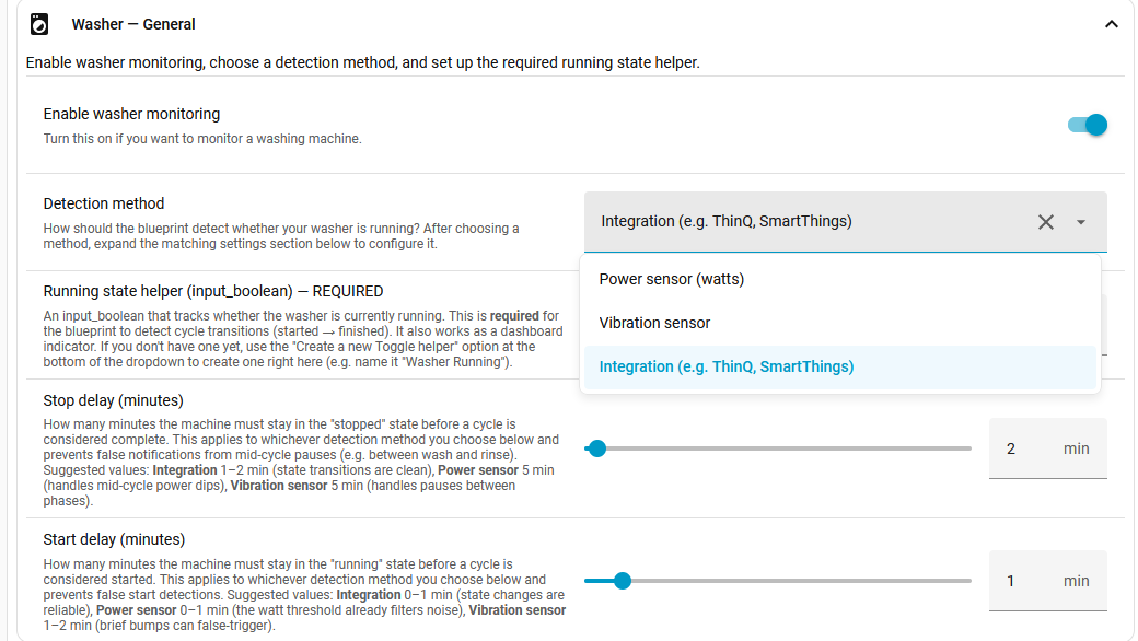

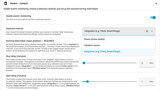

  • Power sensor — smart plugs, panel monitors. Watts above threshold = running.
  • Vibration sensor — dryers, no-plug setups. Vibration detected = running.
  • Integration — LG ThinQ, SmartThings, etc. You pick which states mean "stopped".
Each machine chooses its method independently. You can use a smart plug for the washer and an integration for the dryer, or any combination. The Integration method doesn't require template sensors, the blueprint handles the logic internally.

  • Configurable start and stop delays to avoid false triggers from mid-cycle pauses

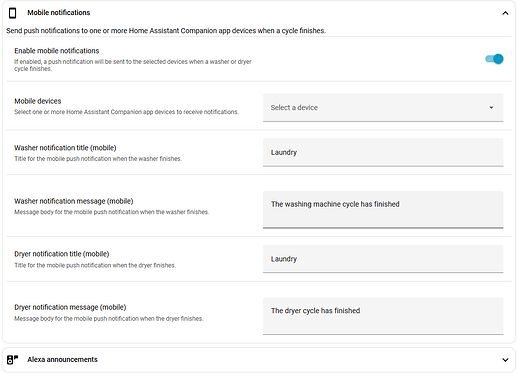

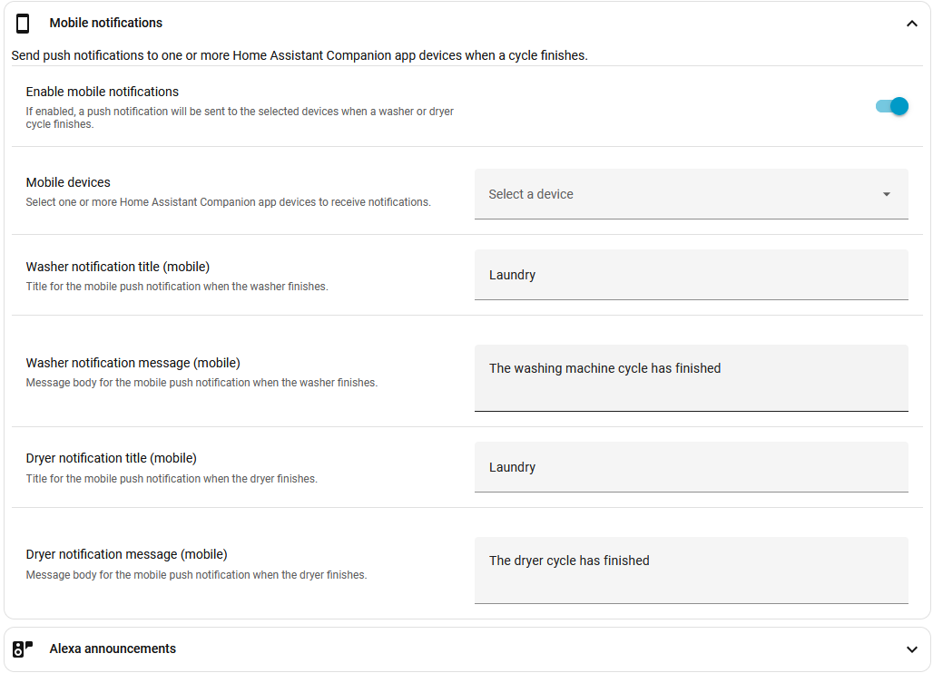

  • Mobile push via Home Assistant Companion app (multiple devices)

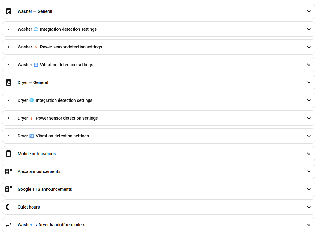

Import the blueprint, create an automation from it, and open the configuration. Every section has detailed descriptions, tips, and examples built into the UI to guide you through setup. I put a lot of care into making the wizard as self-explanatory as possible.
The only required setup per machine is an input_boolean helper (you can create one right from the dropdown) and selecting your detection method. Everything else (notifications, quiet hours, handoff, status text) is optional and collapsed by default.

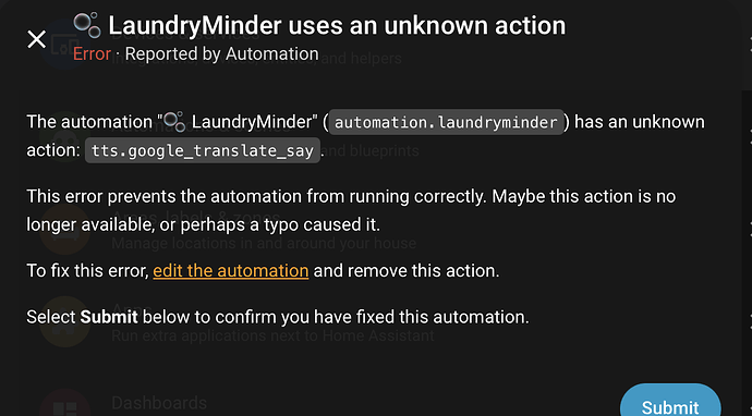

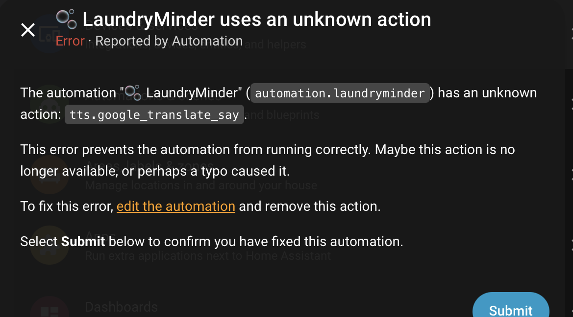

Thanks for the blueprint. I seem to be getting the following error for tts.
:bubbles: LaundryMinder v1.1.0 — TTS fix + flexible speaker support
@knozturk Thanks for reporting the tts.google_translate_say error. That’s been fixed in this update.
Home Assistant deprecated the old tts.google_translate_say action in recent versions and replaced it with tts.speak. If you were using Google TTS announcements, the blueprint would throw an “unknown action” error and fail to send speaker notifications. This update migrates to the modern tts.speak action, which resolves the error.

  • Fixed: Migrated from deprecated tts.google_translate_say to the modern tts.speak action. No more “unknown action” errors.
