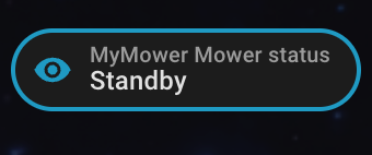

Got it, thanks for investigating. By the way, my lawn mower is currently offline. The app correctly shows it as “Offline”, but in Home Assistant it still shows as “Standby”.
Can you create an issue here: Issues · Sdahl1234/Sunseeker-lawn-mower · GitHub
with more information.
