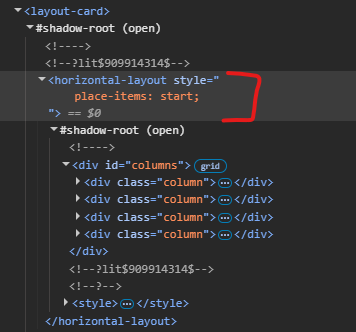

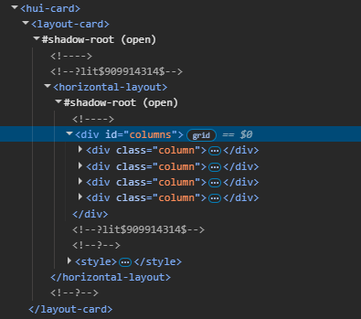

I have a horizontal layout card where each column is rather “min width” to fit the content inside. The problem I’m facing is that the content is aligned to the center of the layout-card HTML object.
      - type: custom:layout-card
        layout_type: custom:horizontal-layout
        layout:
          max_width: initial
          place-items: start
          card_margin: 10px
        cards: ...
This is generated:
I need to position the elements to the start (left) of the horizontal-layout HTML object, with the CSS object place-items: start.
There are 2 options:
  • To add the place-items: start to the horizontal-layout element
  • Or add the justify-content: start to the #columns div, which has, by default in the card, the value set to center
I tried with card_mod even, but I can’t make it work, because it is not a ha-card. Any advice?
I love you mate.
If you ever come to Italy one day, send me a message and I’ll buy you a beer (or even two).
By(t)e

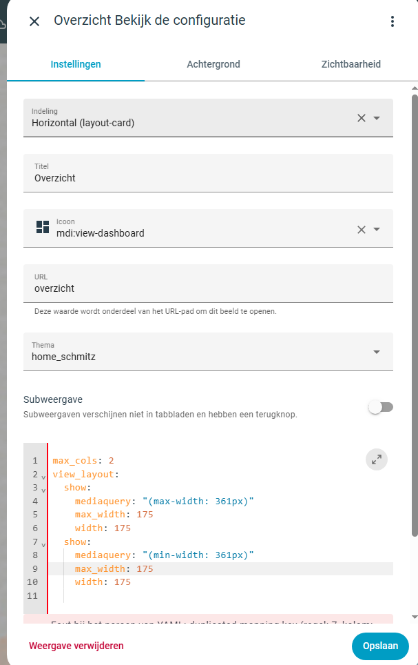

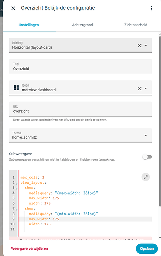

Is it possible to set the with depended on the screen size of a device?
I tried with show, but can not get it to work.
For my older android i would like to have a smaller dashboard and for my newer/langer screen a bigger size.
(ps. examle shows twice the same width, ofc thats wrong/for test.)
But they have bothe the same size?

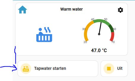

I’m trying to place a 2-button row under a 380px-wide status block. With unequal columns (e.g., 280px and 100px) using custom:layout-card, the left edge of the row shifts inward compared to the status block above. With equal columns the alignment is fine. This happens both with Tile and with Mushroom template cards.
The goal is simple: 380px container, same 4px L/R padding as the status block, and a 2-column row (wide “Start” + narrow “Off”) that aligns exactly left with the status block.
layout_type: grid
layout:
  grid-template-columns: 280px 100px
  grid-gap: 0
cards:
  - type: tile
    entity: switch.tapw_timeprogram_bms_forced_qube2
    icon: mdi:hot-tub
    vertical: false
    tap_action:
      action: call-service
      service: switch.turn_on
        entity_id: switch.tapw_timeprogram_bms_forced_qube2
    card_mod:
      style:
        ha-tile-info$: |
          .secondary { display: none !important; }
  - type: tile
    icon: mdi:stop
    vertical: false
    tap_action:
      service: switch.turn_off
    card_mod:
      style:
        ha-tile-info$: |
Play with negative margins in layout block:
layout:
  margin: "-4px -4px -4px -4px"
  grid-gap: 0
Can you share the entire card code to include the top card?
As mention, a negative left margin may solve your issue
layout_type: grid
layout:
  grid-template-columns: 40% 60%
  margin: 0px 0px 0px -14px
cards:
  - type: tile
    entity: switch.xxxx
    icon: mdi:hot-tub
  - type: tile

Big thanks.
I started with margin. left -4px did the trick for the left side. Unfortunately, the right side started to shift left which I could not solve with margin option.
grid-template-columns: did the trick, I increased the second column by 8px. Although the total value exceeds the 380, the two items are now aligned.
  layout:
    margin: 0px 0px 0px -4px
    grid-template-columns: 280px 108px
    grid-gap: 0
Glad it worked out and happy to assist!
This happened because you specified fixed widths in pixels. This could be prevented by:
grid-template-columns: 280px auto
Or
grid-template-columns: 70% 30%
Tried both option and with both options there is a small indent on the right side.
I might have understood if I had to add 4px (so 104px), but I don’t understand is why I have to add 8px if width is 380px, margin -4. Might be that the status block is 384?

Layout Card adds the following margin by default: 0px 4px 0px 4px
See under the heading Layouts here: GitHub - thomasloven/lovelace-layout-card: 🔹 Get more control over the placement of lovelace cards.
We can suppress this standard margin as follows:
margin: 0px -4px 0px -4px
That should make my suggestions for grid-template-columns work. You may need to readjust the margin values a little.
Tested both options with
And indeed they both give the expected result!.
Thanks
You’re welcome. I’m glad it works.
