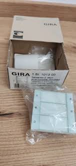

There are many ways to achieve this, “chacun à son goût”. For my part I deactivated the automatic lights. In fact there is always some light at night, be it because of open shutters or the backlight of the Gira 1013 in each room.
