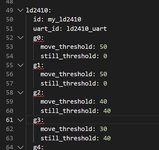

I just setup move and still thresholds and want to save it some how,
what options do I have? Ideally I want to save thresholds to yaml.
But this way doesn’t work.

I mean to save thresholds values to avoid it setting up again in case of factory reset or new setup new board
They are meant as inputs, I think the values are stored in the sensor itself. When I moved one to a new esp, the settings remained intact. If you really need to have the values in yaml, you can create a script to set the values.

Can anyone tell me whether the individual gate movement values can be read in a lambda ?
e.g. set and id for the g0 move energy
 g0:
      move_energy:
        internal: true
        name: g0 move energy
and read
ESP_LOGD("CUSTOM"," G0 move %d", id(g0MoveEnergy).state);
However the value that is logged is not the sensor value
It always seems to be -2147483648
same for
ESP_LOGD("CUSTOM"," G0 move %d", id(g0MoveEnergy));
both times it looks like the value is simply a pointer to a data struct or pointer to function.
:frowning:
