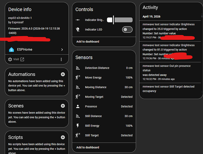

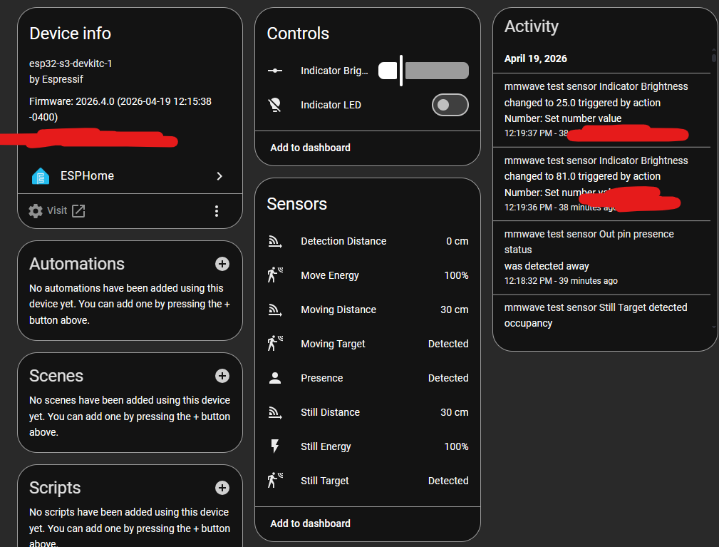

LD2410C not working until the UART gets replugged

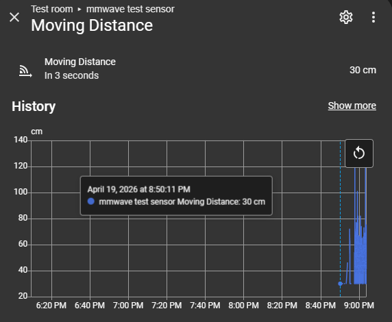

TLDR; the ld2410c works when it’s disconnected form the UART bus for a few seconds then freezes (doesn’t report data anymore).
When powering up the ESP32S3 with the LD2410C connected, the sensor values read as Unknown until I physically disconnect TX/RX for a few seconds. It updates the values in HA then it stays stuck. Removing the UART wires and power cycling it, the LED I connected to the OUT pin on the LD2410C begins working again. Should I get an LD2450 instead?
