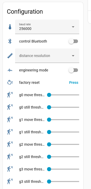

I’m trying to use a LD2410 Humand Presence Sensor, but its movement and static threshold values get reset to zero every time I power cycle it.
The values don’t go back to the factory settings, all the thresholds get set to zero

After some experimentation, it seems that the HA config page for the LD2410, is not initially querying the device, and hence displays zero on all sliders

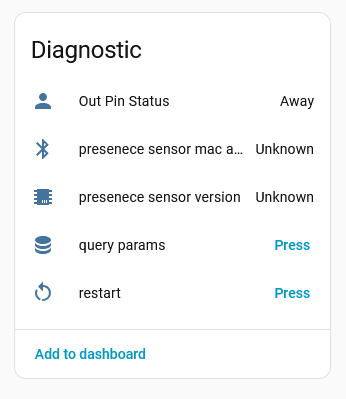

However, if I press the ‘Query Parameters’ button on the Diagnostic panel
Then all the sliders get updated with the correct values.
So IMO this seems to be a bug in the HA side of things, because when the ‘Device info’ page on the HA server is loaded, it should automatically query the device paramaters.
I thought because the device was not working correctly, that the problem was that the config sliders were being reset, but this doesn’t seem to be the case.
I’ll see if I can post a bug report for the parameters not being queried, but I’m not sure where to post the bug on GitHub, i.e is this bug in HA or EspHome, or perhaps the ESPHome repo contains the HA HTML display code etc???
