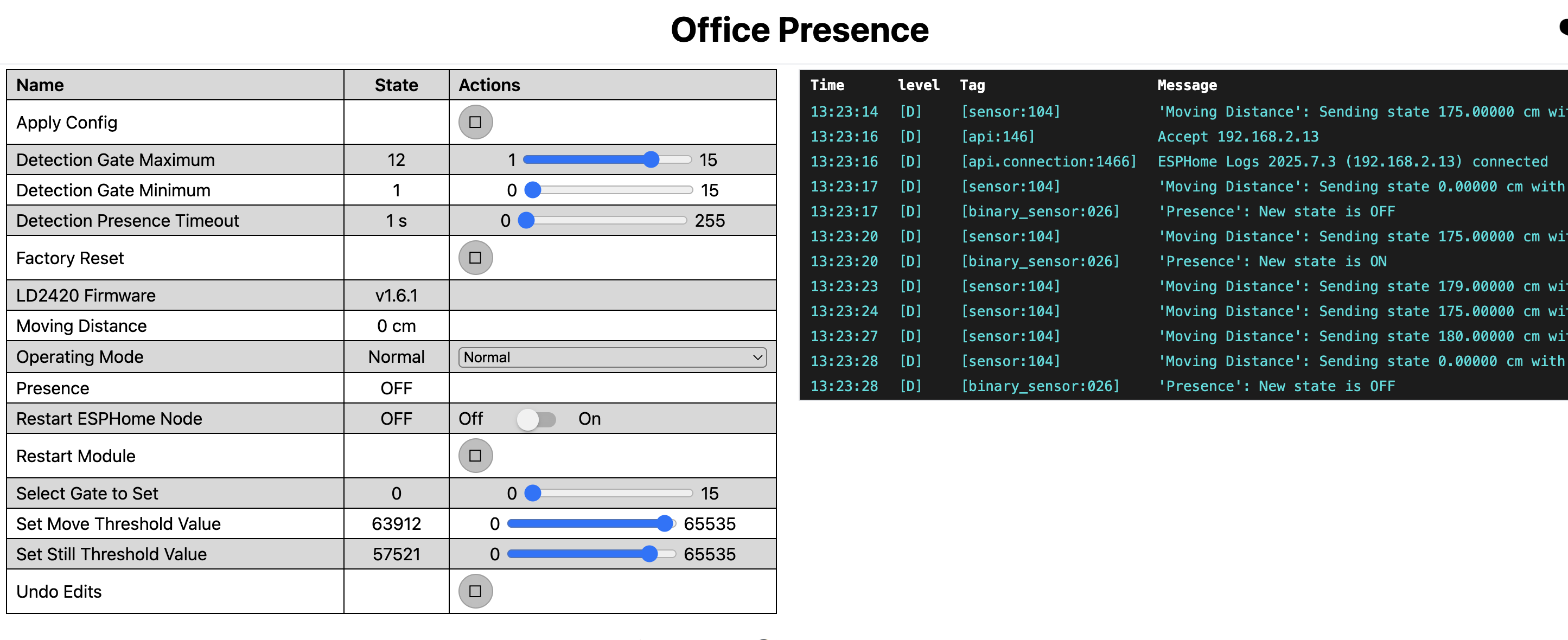

I didn’t see anything obvious in the logs at all. The best way I can describe it is that it’s almost as if it’s configuration just “goes away”. Hard reboot (pull power) brings it back - then after several hours it just happens again… This is pre-reboot after it’s stopped working:
and log output (pre-reboot) as you can see it’s “lost” all data about the LD2420 just as displayed in the UI:

This is post hard reboot and it’s working again:
of course the logs reflect normal operation again as well.
