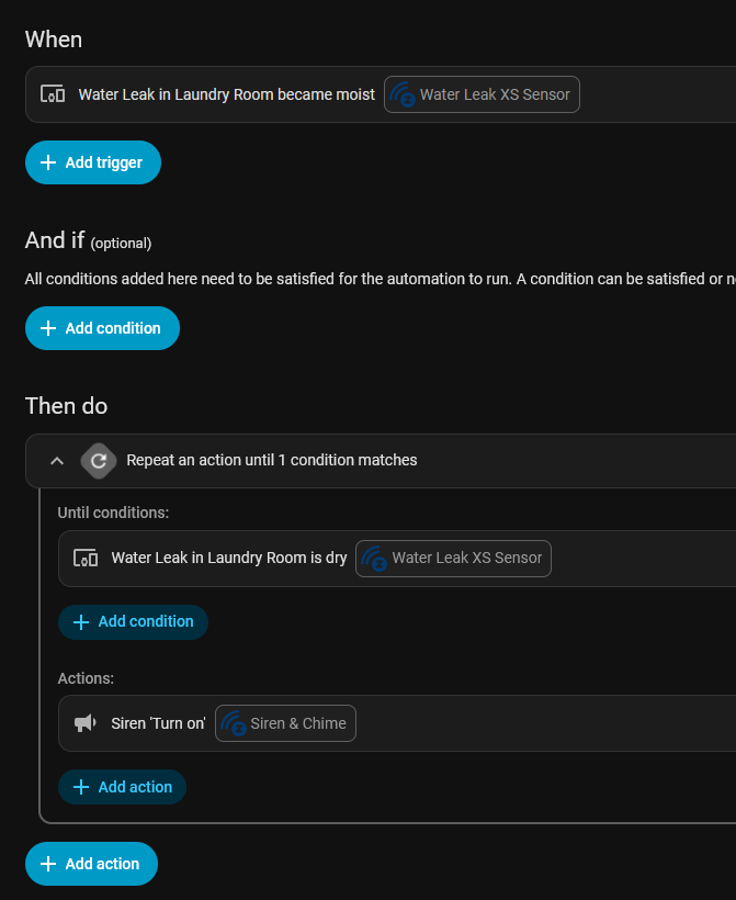

I setup the automation and w/o a repeat function, I can reliably get the 1-time Siren to work. But if I setup the automation to try to keep repeating the Siren message until the leak condition ends, it goes sideways. In fact, it seem to only actually siren until AFTER I remove the water trigger.
This is what the automation looks like. I don’t where this is setup wrong.
Any suggestions?

Please follow the Community Question Guidelines by posting your automation’s YAML configuration… it makes it a lot easier for us to see any possible issues that may be hard to spot in a screenshot of the UI Automation Editor.
One possible issue that I can see is that you may need a delay following the siren action to avoid collisions if the repeat is calling the action over-and-over again every few milliseconds.
Sorry. Fairly new to HA automation. I posted the YAML but it’s for each section of the automation. Not sure if that’s what was needed.
If you click the 3-dot/breadcrumbs icon in the top right corner in the Automation editor there is an option “Edit in YAML” which will show the whole thing all together.
I don’t see anything wrong in what you have posted. Did you try adding a Delay action?
Haven’t tried a delay action because I’m not sure WHERE in the logic to add it.
Updated the YAML code. Thanks for pointing out where I could get the whole block at once.
And again, the way this is currently behaving is that I see it triggered initially, but no siren. Then once I remove the water from the sensor, about 2sec later I get the siren message. Completely repeatable. Seems like it’s working backwards.
The delay needs to be inside the Repeat, after the siren action:

There we go! That fixed it perfectly!!! Thank you!!
