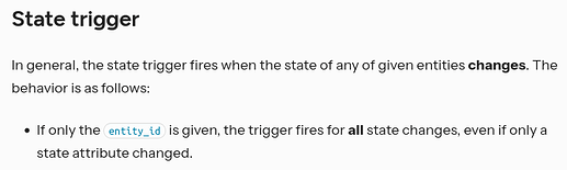

It will send multiple because the trigger you are using will fire on every state change.
OK, but does that trigger happen for any temperature changes or only those which occur affecting the boundary conditions? for example, if the temperature goes from -18 to -19 C or from -13 to -14 C will that trigger an alert?
Thanks, I’m learning…RDK

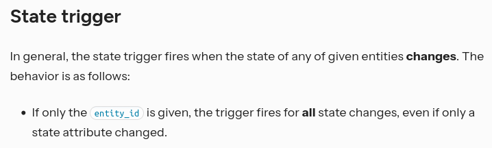

Yes. Also, if the sensor has any attributes that change, those too will cause the trigger to fire.
Automation Triggers - State
Yes, based on the config shared above, you will be getting constant notifications… probably a lot more than you actually want.
It will trigger, but the condition will cause it to not send a notification.
That’s what I believe. It’s hard to read your code since it’s not formatted correctly
