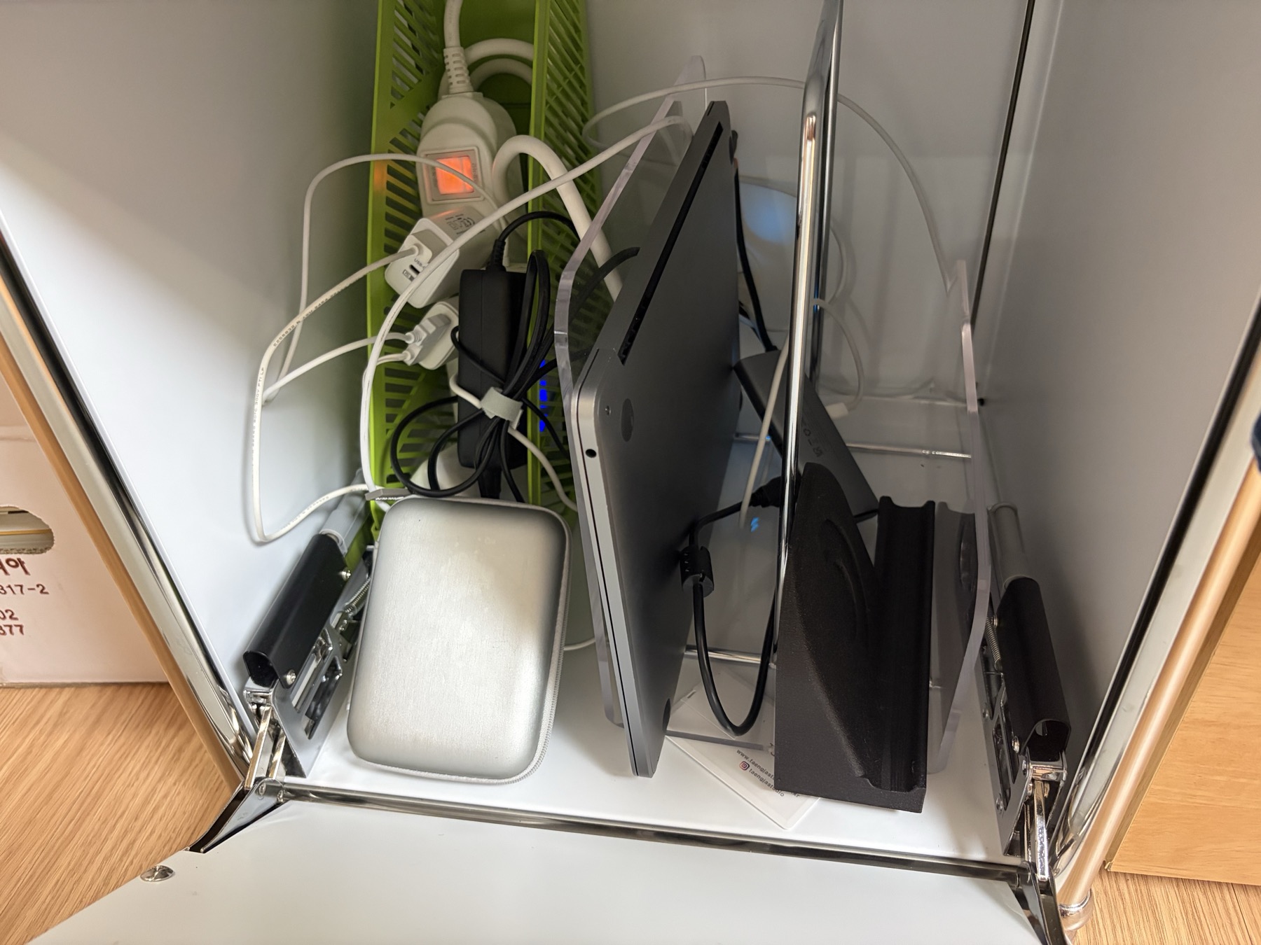

The server is the part people will yell at me about: it’s my old M1 MacBook, lid closed, kept awake with caffeinate. Yes I know, get a Pi, get a NUC. But the M1 was sitting in a drawer doing nothing, it’s completely silent, it has a built-in UPS (the battery, 210 cycles and still fine), and the full stack barely registers on it - the Stream Deck next to it shows 9.6 W package power, CPU at 68 C, fan at 1,212 rpm. The Mac itself has been up 31 days, longer than this server project has existed. The compose volumes are all relative paths, so the day I do buy a Pi 5 I copy one directory and go. Both arm64, same images.

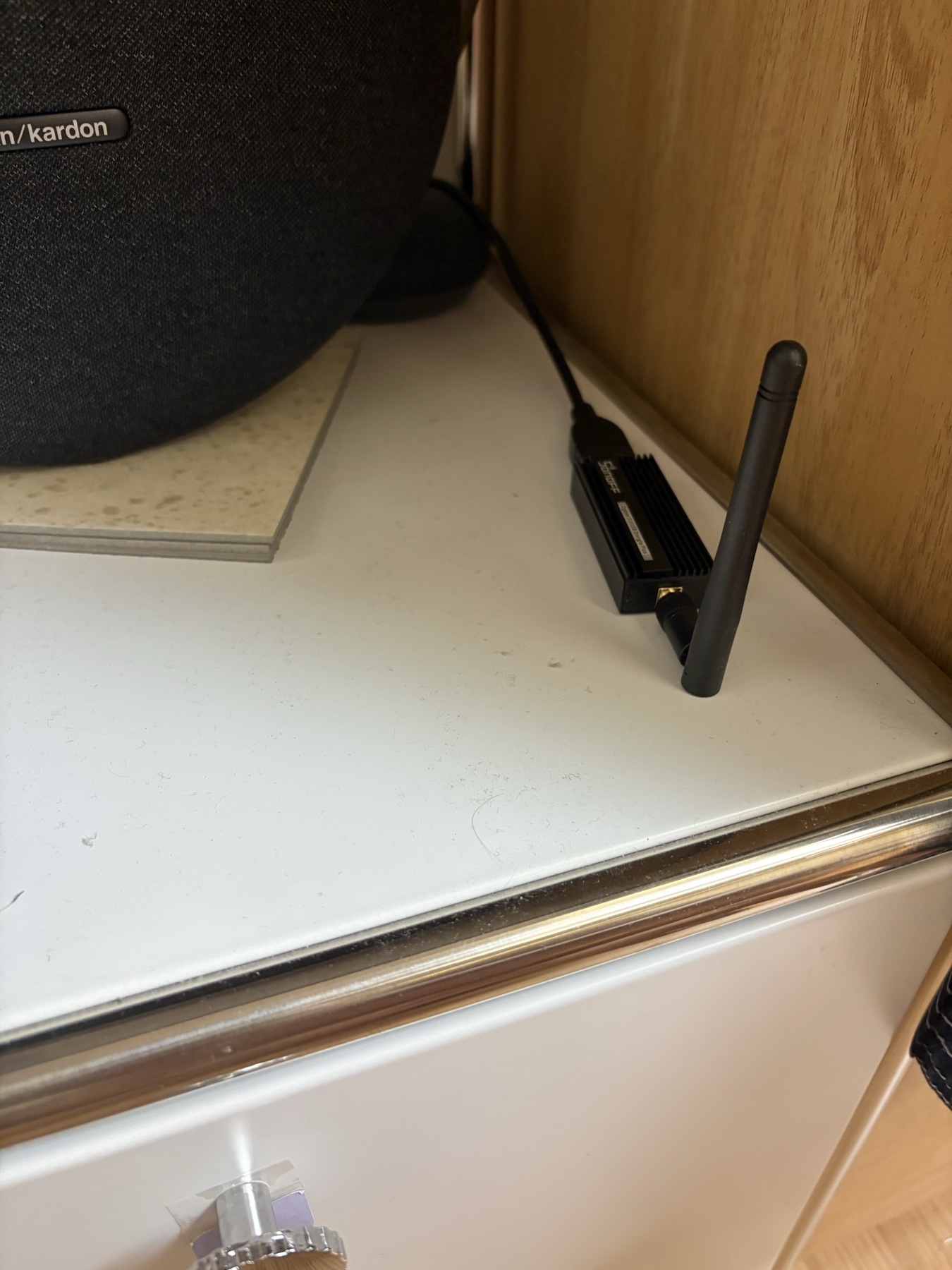

Coordinator is a Sonoff ZBDongle-P. Stack is Home Assistant + Mosquitto + Zigbee2MQTT + Postgres under docker compose. Sounds like an afternoon of work. It was not, and macOS was the reason, twice.
First trap: the HA image wouldn’t unpack. invalid tar header, right at the end of a 100% completed download, which looks exactly like a broken network. I re-pulled it three times before checking the actual cause: HA ships its layers as tar+zstd, and Docker older than 23.0 doesn’t know zstd, so it assumes gzip and dies at the last moment. My Docker Desktop was an ancient 20.10. I ended up on colima rather than upgrading Desktop, which brought its own comedy: the Mac now has two docker binaries and the dead one comes first in PATH.
Second trap, and this one has no workaround: you cannot pass a USB device into a container on macOS. Docker Desktop and colima both run containers inside a VM, and the dongle simply doesn’t exist in there. So Zigbee2MQTT runs natively on the host, outside compose, pointed at the same data directory the container would use (so the pairings survive the eventual Pi move without re-pairing 20 devices).
And then, with everything finally in place, I plugged in the dongle and Z2M died on startup. Every single time, getExtAddr timeout. I probed the dongle by hand with raw serial commands to prove it wasn’t bricked (it wasn’t). The real cause took three evenings to find, it’s buried in zigbee-herdsman, and it’s darkly funny - the fix was a 60-line Python script and I’ll write it up later in this thread because it deserves the space. (The post right after this one is about the wallpad, the Korean apartment panel that owns my ceiling lights and, as it turns out, the elevator.)

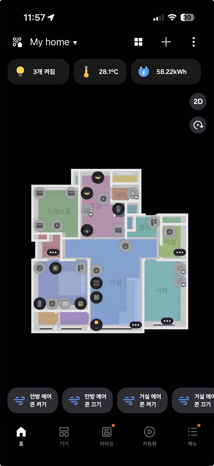

The one ST screen I did miss was the Map View. Here’s what it looked like in July:

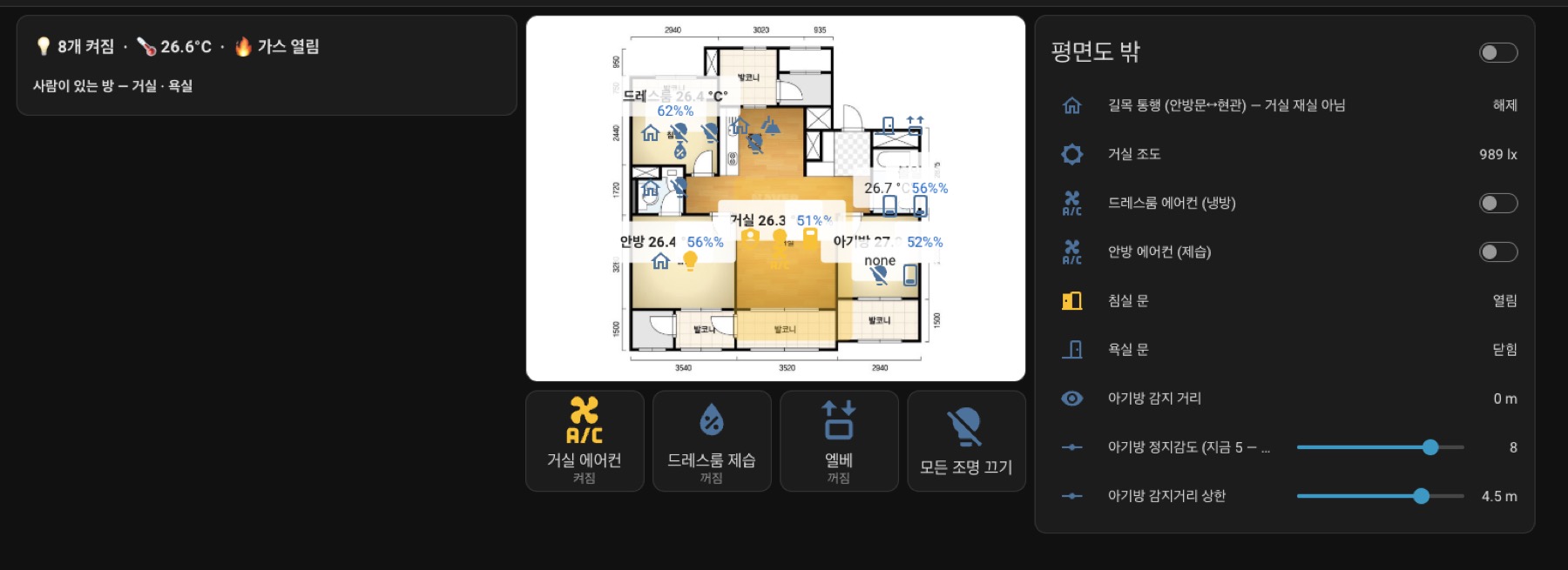

Pretty, right? This is the part ST genuinely does well. So I rebuilt the idea in HA as a floorplan dashboard: live temperature, lights and presence per room, plus the four buttons we actually use. One of those calls the elevator, which is the wallpad post’s problem to explain.

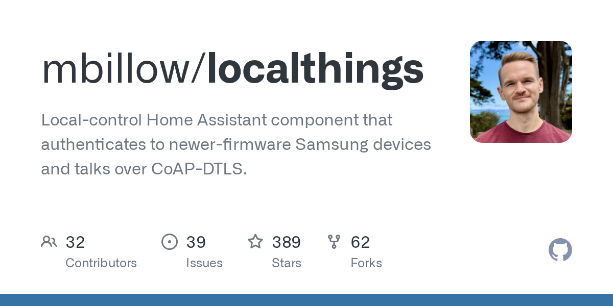

Not aware of LocalThings (yet) :thinking: ?
Nice, a Beelink is basically the Pi-adjacent path I’ll end up on too, so it’s good to hear it’s been solid a month in. For anyone on the fence, that’s the boring-and-correct choice next to my “old MacBook with the lid closed” setup. I just happened to have the M1 sitting idle, and it’s also running a couple of AI agents on the side, so it earns its keep.
How are you deciding which integrations to pull at the second location? Going by Samsung’s published list of what gets metered, or waiting to see what actually breaks in October? I haven’t found a clean answer on that myself.
I wasn’t, and I just went down that rabbit hole, so thank you. For anyone else reading: LocalThings talks to newer Samsung appliances locally over CoAP-DTLS, no cloud involved, so the October change doesn’t touch it. Timely for me - my washer and fridge are both still hanging off the old cloud integration and sit there unavailable right now. I’ll have to check what firmware they’re on before getting my hopes up, but I’m going to give it a go this weekend and report back either way.

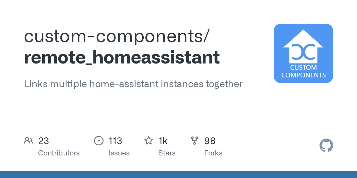

I haven’t figured the out yet. The following is one Gemini’s suggestions:
That one sits on top of what I described rather than replacing it. It connects to the remote instance’s websocket API and forwards service calls back, so it still needs to reach that box in the first place, which is the part the overlay network handles. Worth reading before you set it up: there’s a thread on the front page right now where someone put the token on both instances instead of just the main one, and the two of them re-imported each other into 55,000 entities that HA then refused to delete. I haven’t run it myself, so that’s as far as I can help.
Follow-up on the LocalThings tip, since I said I would report back. It worked: the fridge went local about twenty minutes after I put the integration in, and it gives me 28 entities where the cloud one gave 13. One day in, it has not gone unavailable even once, 1,194 power readings between 3 and 273 W, 37 door opens recorded. The washer is a different story, it simply refuses the handshake, because the 2025 laundry firmware trusts a different root than the certificate this integration signs with, and that is an open issue upstream (localthings #435). So one of the two is off the cloud, and it happens to be the one I cared about more. Thank you for pointing me there.
Hmm, that surprises me a little…according the dev only the older firmware’s aren’t supported :thinking:
This needs an appliance on Tizen RT 3.x / DAWIT 3.0+ firmware (roughly 2022+), which exposes a local DTLS-CoAP API. Older firmware (roughly 2018-2022) only talks to Samsung’s cloud over token-based HTTPS and isn’t supported
But maybe this is not a Tizen RT 3.x / DAWIT 3.0+ firmware ?
According my ‘friend’ (chatGPT):
  1. ~2022 onward: newer appliances use Tizen RT 3.x / DAWIT 3.0+, with local CoAP over DTLS on UDP 49152–49160.
  2. 2025/2026 dryers: I don’t see evidence that Samsung has moved dryers to a fundamentally new firmware platform beyond the DAWIT 3.x / Tizen RT family. There can of course be newer firmware builds/versions within that family.
Edit:…oh, I see the issue now…Architecture: PSK and server-authenticated OCF device support · Issue #435 · mbillow/localthings · GitHub
