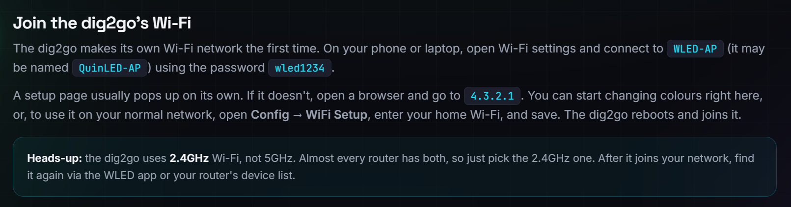

In the advertising on the site, it is not clear that the dig2Go has wifi. Do all models of the smaller dig2GO have wifi and work with HA out of box?

ESP32, so definitely has wifi. Also, it’s explicitly mentioned in the getting started guide.
