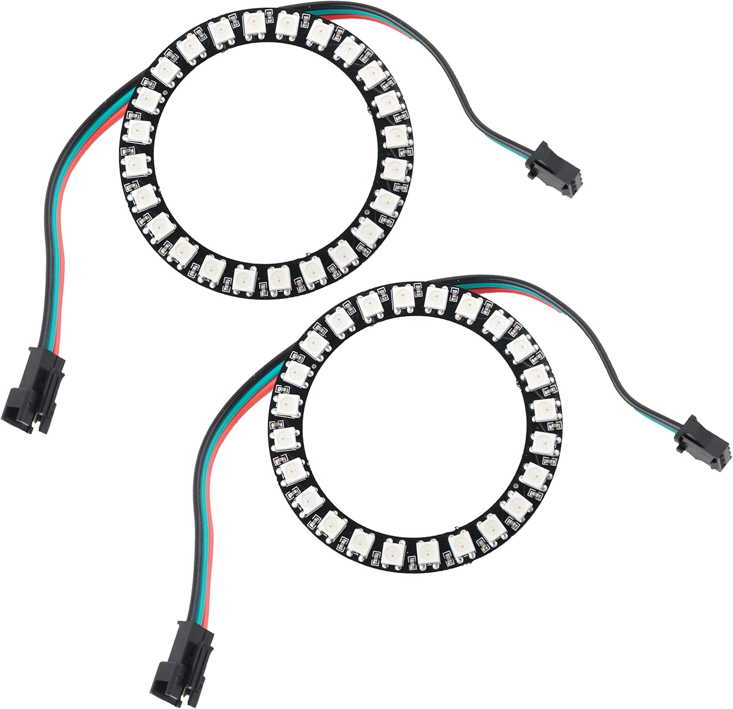

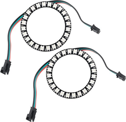

I already took a look into those:
But they can’t be cut to length as it seems?

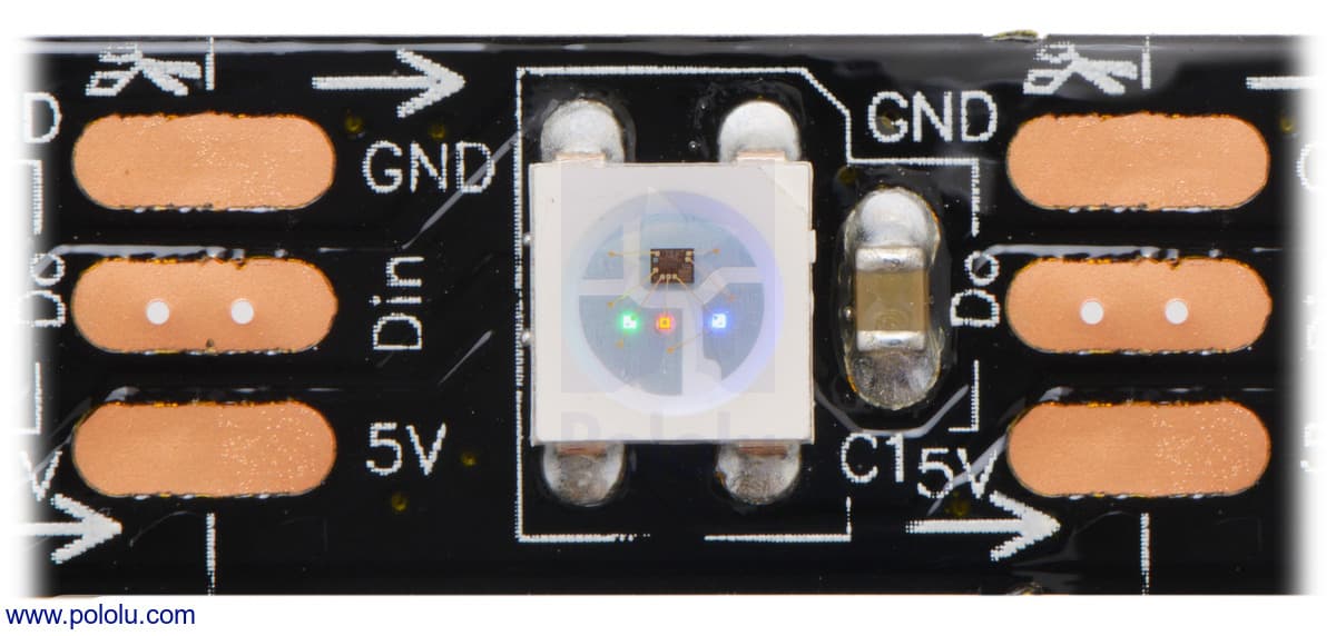

You can easily cut addressable led strip in single pieces and solder wires to reconnect them. There are cut lines and solder pads ready for that.
oh right you are!
I totally forgot that adressable LEDs can be cut on every single dot.
Thanks a bunch!!

Thanks, but I need this with 70cm diameter :slight_smile:
