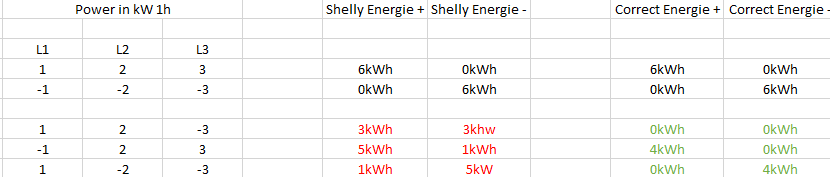

I took the script from here:
Why:
e.g. if i get 3kw consumption and 3kw gain from solar power, don’t calculate this to zero.
from https://community.shelly.cloud/topic/3027-verständnisfrage-zum-saldieren/
