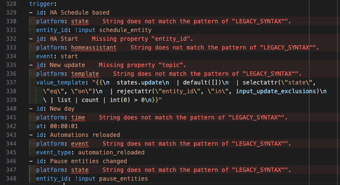

I have this code from the Home Assistant Auto-update v2024.9.30.0 blueprint:
trigger:
- id: HA Schedule based
platform: state
entity_id: !input schedule_entity
- id: HA Start
platform: homeassistant
event: start
- id: New update
platform: template
value_template: "{{\n states.update\n | default([])\n | selectattr(\"state\",
\"eq\", \"on\")\n | rejectattr(\"entity_id\", \"in\", input_update_exclusions)\n
\ | list | count | int(0) > 0\n}}"
- id: New day
platform: time
at: 00:00:01
- id: Automations reloaded
platform: event
event_type: automation_reloaded
- id: Pause entities changed
platform: state
entity_id: !input pause_entities
That gives me these LEGACY_SYNTAX errors:
CrapGPT is unable to correct this code… Can someone point me in the right direction?

Replace all instances of the word platform: with trigger:
On line 328, replace the word trigger: with its plural form triggers:
If elsewhere in the blueprint there is a line containing the word action: replace it with its plural form actions:
If there are instances of the word service: then replace them with action:
Old style
alias: example
trigger:
- platform: state
entity_id: binary_sensor.foo
condition: []
action:
- service: switch.turn_on
entity_id: switch.bar
New style
alias: example
triggers:
- trigger: state
conditions: []
actions:
- action: switch.turn_on
Sir_Goodenough
((SG) WhatAreWeFixing.Today)
October 15, 2025, 2:28pm
3
It is not an error.
It’s a notification that you are using old syntax.
Contact the author of the blueprint about this but it will work fine as is, assuming you don’t want to take control of the blueprint or edit it yourself.
If you do want to edit the blueprint, 123 has instructions above.
