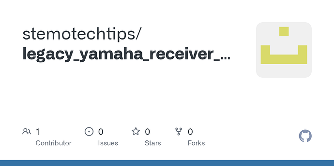

Installing
The integration can be installed with HACS - you just need to add it as a custom repository:
Once installed, you can add it as an integration as normal. It has preliminary support for discovering receivers over the network using SSDP, but if that fails you can provide the IP address directly.

This integration uses a separate Python library I created, which also allows for some more low-level interaction with the receiver.
