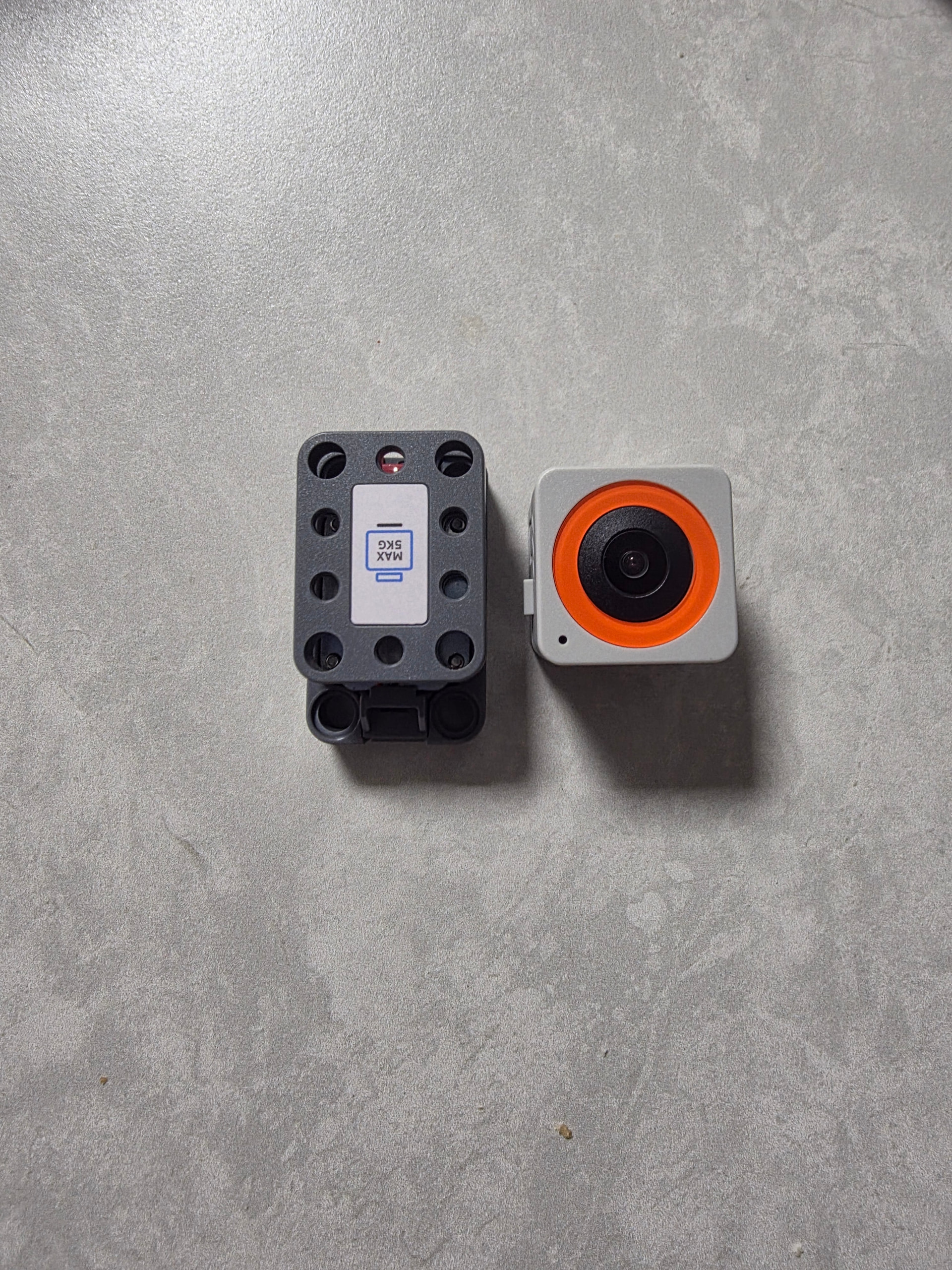

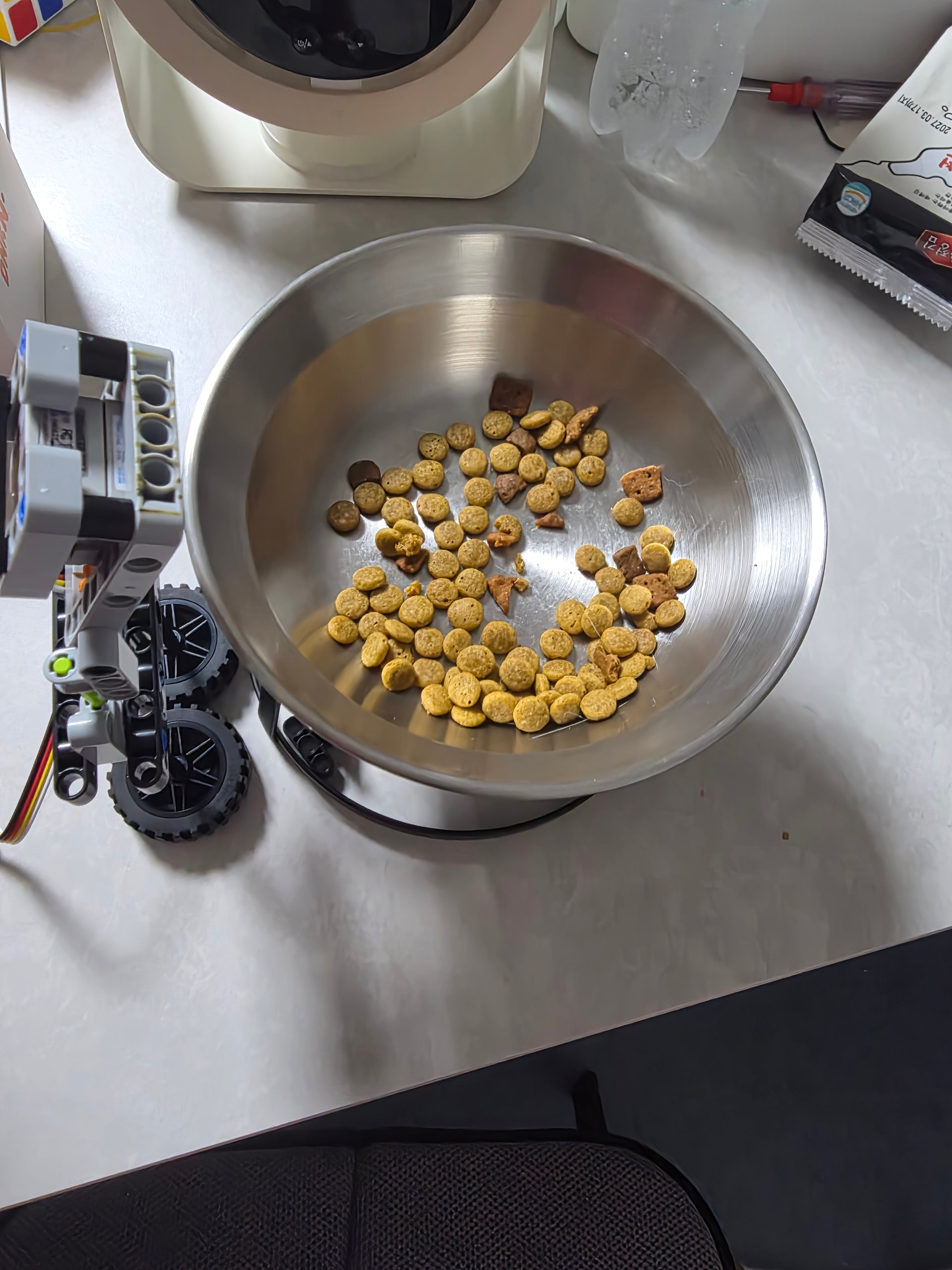

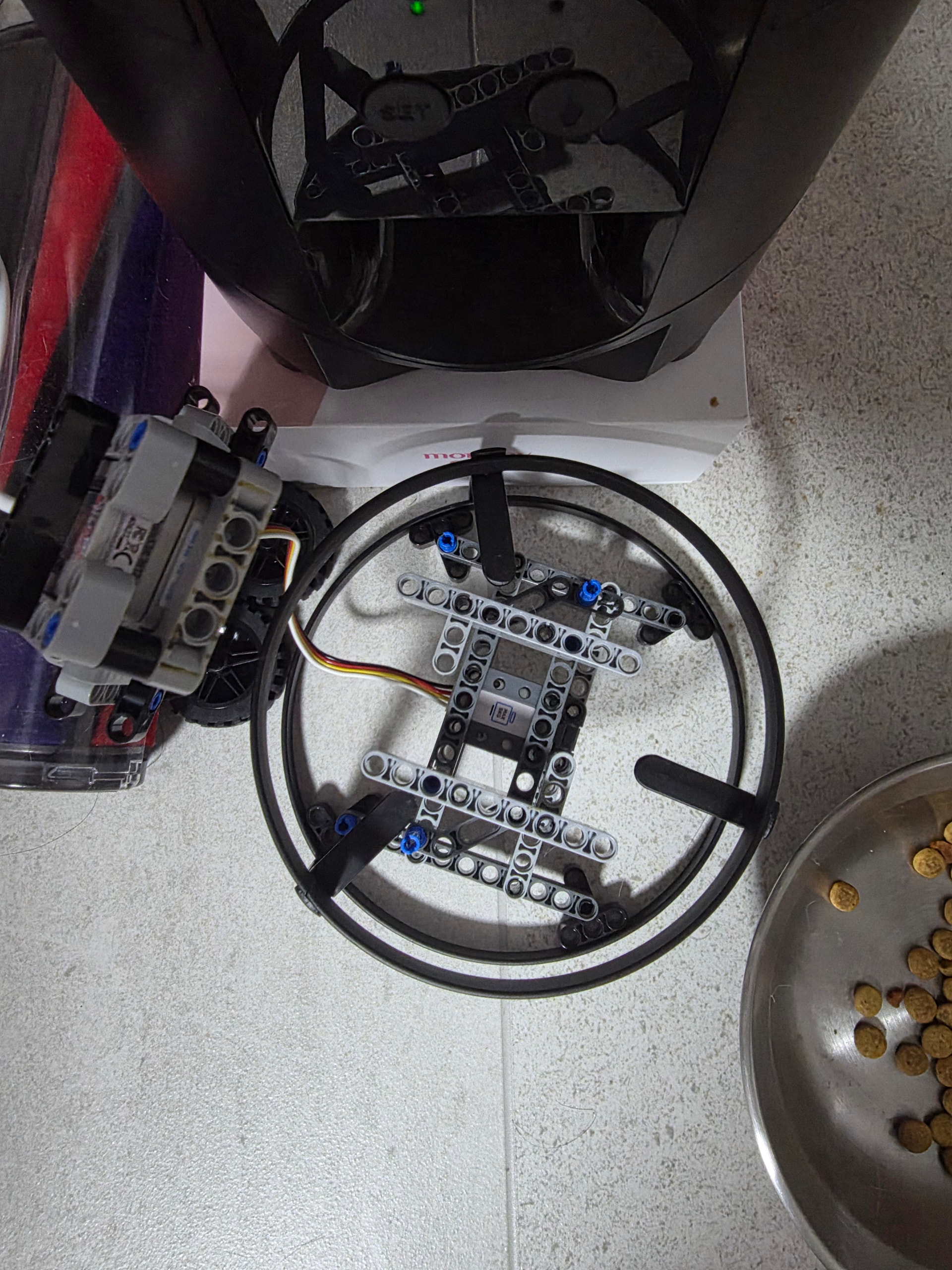

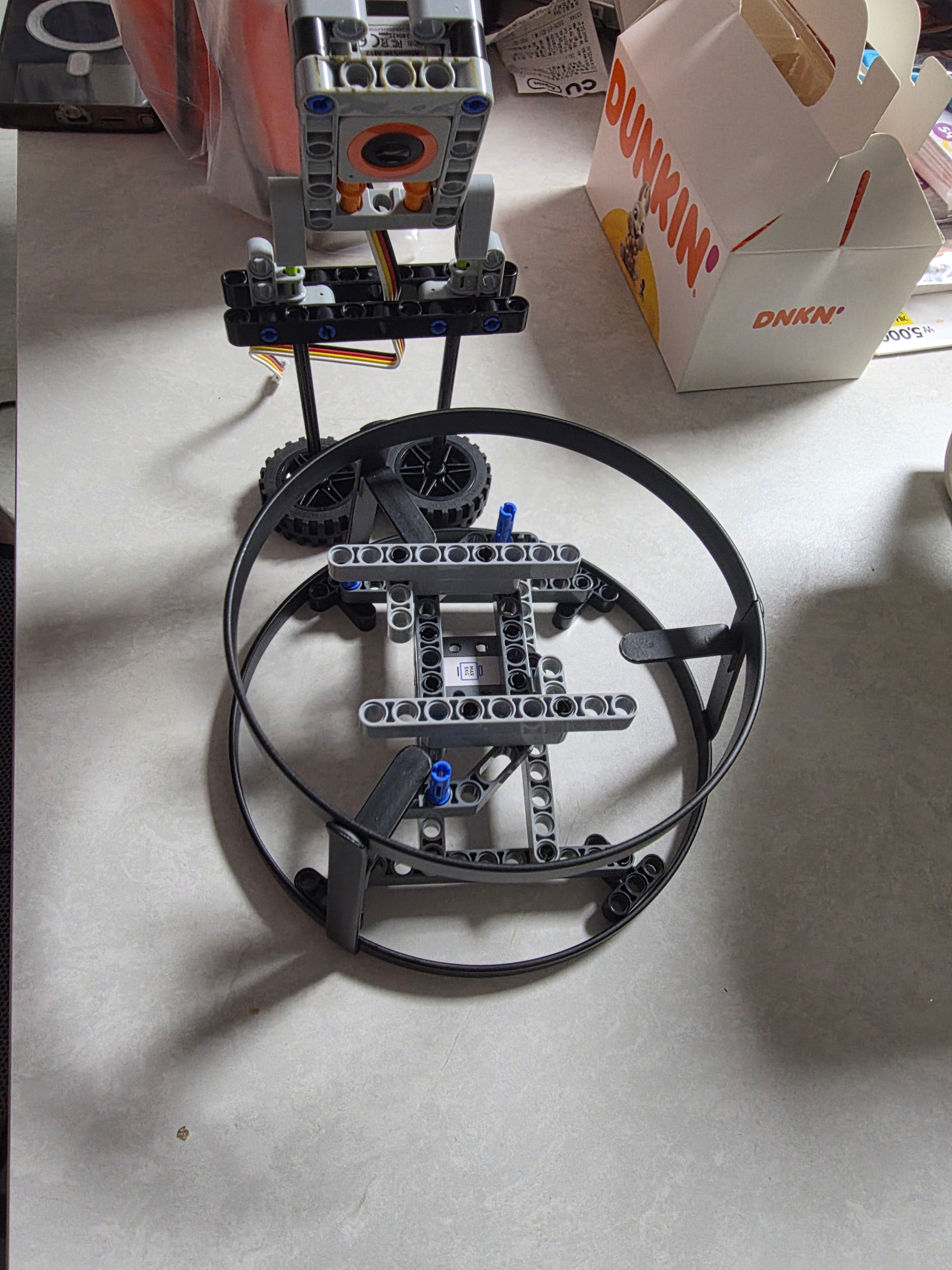

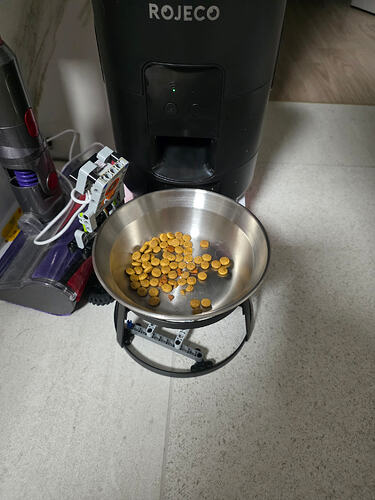

I built a pet food bowl scale using Lego bricks, M5Stack AtomS3R-M12, and M5Stack Unit-Mini Scales. It is integrated into Home Assistant via ESPHome.
This setup allows me to monitor food weight and check on my pet via a live camera feed.

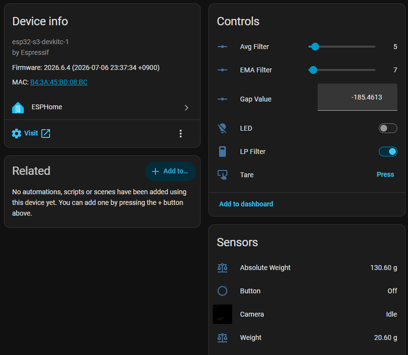

  • Zero-point calibration (Tare) from Home Assistant.
  • Custom digital filters (Average, EMA, LP Filter) adjustable from the dashboard.
