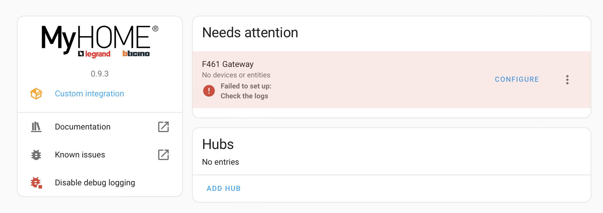

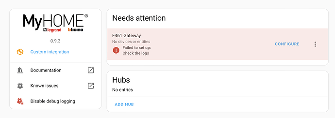

Hello everyone!
I’ve tried to install the Bticino MyHome integration in HA but I get some errors I cannot solve by myself!
The first thing was to configure the F461 gateway, but as you can see in the screen below, I get the “Failed to set up” error.
Is this referring to the myhome.yaml file? My myhome.yaml file is this one:
f461
mac: ‘XX.XX.XX.XX.XX.XX’ (of course I put the correct mac address here)
light:
dining_room:
where: ‘06’
dimmable: False
manufacturer: BTicino
model: F411U2
and I put the file in the “config” folder in the HA main folder, as well as in the main folder because I was not sure where to put it.
I also have the following log file but I cannot actually understand what’s the issue:
2025-02-25 13:27:38.960 ERROR (MainThread) [homeassistant.config_entries] Error setting up entry F461 Gateway for myhome
  • File “/usr/src/homeassistant/homeassistant/config_entries.py”, line 640, in __async_setup_with_context*
  • result = await component.async_setup_entry(hass, self)*
  • File “/config/custom_components/myhome/init.py”, line 62, in async_setup_entry*
  • _validated_config = config_schema(yaml.safe_load(await yaml_file.read()))*
  • File “/usr/local/lib/python3.13/site-packages/yaml/init.py”, line 125, in safe_load*
  • return load(stream, SafeLoader)*
  • File “/usr/local/lib/python3.13/site-packages/yaml/init.py”, line 81, in load*
  • return loader.get_single_data()*
  • File “/usr/local/lib/python3.13/site-packages/yaml/constructor.py”, line 49, in get_single_data*
  • node = self.get_single_node()*
  • File “/usr/local/lib/python3.13/site-packages/yaml/composer.py”, line 36, in get_single_node*
  • document = self.compose_document()*
  • File “/usr/local/lib/python3.13/site-packages/yaml/composer.py”, line 55, in compose_document*
  • node = self.compose_node(None, None)*
  • File “/usr/local/lib/python3.13/site-packages/yaml/composer.py”, line 84, in compose_node*
  • node = self.compose_mapping_node(anchor)*
  • File “/usr/local/lib/python3.13/site-packages/yaml/composer.py”, line 127, in compose_mapping_node*
  • while not self.check_event(MappingEndEvent):*
  • File “/usr/local/lib/python3.13/site-packages/yaml/parser.py”, line 98, in check_event*
  • self.current_event = self.state()*
  • File “/usr/local/lib/python3.13/site-packages/yaml/parser.py”, line 549, in parse_flow_mapping_key*
  • raise ParserError(“while parsing a flow mapping”, self.marks[-1],*
  •        "expected ',' or '}', but got %r" % token.id, token.start_mark)*
yaml.parser.ParserError: while parsing a flow mapping
  • in “”, line 1, column 1:*
  • {\rtf1\ansi\ansicpg1252\cocoartf2761*
    expected ‘,’ or ‘}’, but got ‘{’
  • in “”, line 2, column 34:*
  • \cocoatextscaling0\cocoaplatform0{\fonttbl\f0\fnil\fcharset0 .App …*
Is anyone able to help? Thank you so much!

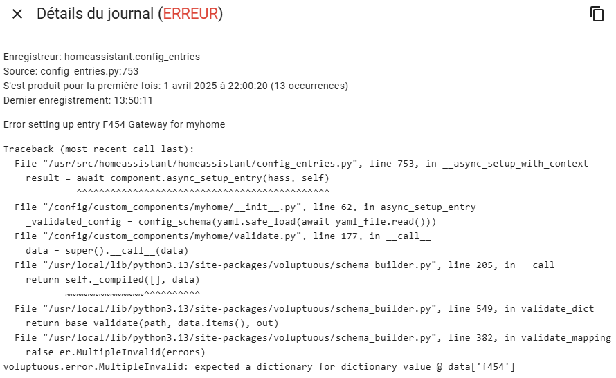

Hello everyone,
First I’d like to thanks @anotherjulien for your work.
I’am a NB with HA, my home is full LEGRAND / BTicino for lights and shutters managed by my cellphone (iMyHome app) / MyHomeScreen / Webserver F454.
So today I’ve decided to test HA & MyHome with a Pi5 config. HA v15.1 and MyHome 0.9.3
I’ve read the actuel topic, and of course GitHub - anotherjulien/MyHOME: MyHOME integration for Home-Assistant but probably not as I should do it because I ve an issue with my configuration.
For testing I’ve set the default OPENWEBNET password to 12345.
Here is some of my screenshot:
My myhome.yaml in the same directory that configuration.yaml
f454:
mac: ‘00:03:50:xx:xx:xx’
light:
Salon:
where: ‘07’
dimmable: false
manufacter: BTicino
model: f411/2
Could you help me?
