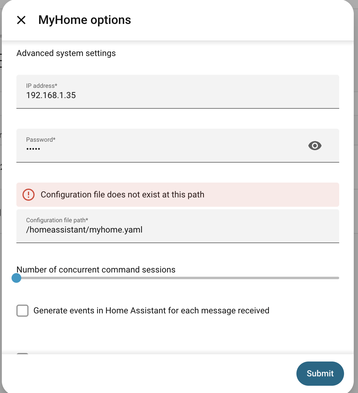

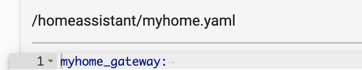

Hi again, i’m using Yalm config file to configurate, but it shows no entities, what am i doing wrong? Tried de where only config like in the old pluging and the who-where. nog difference.
location: /homeassistant/myhome.yaml
myhome_gateway:
  mac: 'my_mac'

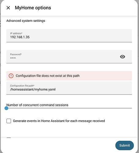

Found the possible problem, but can’t fix it it seems.
THe surelly exists at this location.
Any idea?
@jp_colin Are you sure your myhome.yaml is not in /config/myhome.yaml? That’s the default location for the original MyHome integration (anotherjulien). Chances are your file may be there…
The is what is shown above right?
I don’t even have this folder: /config/
strange, if i put this location in the configuration of hte gateway: /config/myhome.yaml
I don’t get an error, but it does take the light form the myhome.yaml into account.
Also i have my installation with virtual configuration so my devices go from who: 0 to 10 and where 0 to 15.
But the documention say 11 to 99
