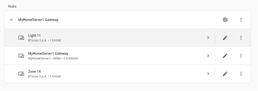

Hi @mantovanelli.matteo - i just installed home-assistant and your plugin.
i use an MyHOMEServer1 - i added the gateway, but when i start an scan it only finds 5 lights (address 11 - 15) - and some zones.
using the passive mode also does not work when i switch on-off an light (for example where=25)
i also see some erros in the logs - any info what that might be?

hey - i am still not able to detect my devices - either via scan or manual via button trigger. however in the logs i see bus_sniffer get all the messages - any idea why those OWNLightingEvent and OWNAutomationEvent are not picked up as devices?

very interessting - now i did a manual button trigger with one roller shutter - suddenly it found 63 new devices?
Thank you Matteo!
Problem solved! Only Light 14 is still not working as in the previous versions, (dimmer works but on/off switches don’t, they only work if i use the official Bticino app), here you can find the new LOG
Thank you very much again!
Hi! Thanks for sharing the logs, they clearly explain what is happening.
There are two distinct reasons why your devices haven’t been added yet despite appearing under [BUS SNIFFER]:
1. Why physical button presses aren’t creating devices yet:
The [BUS SNIFFER] log simply shows that the integration’s background event listener is receiving the frames from your bus. However, the Auto-learning feature is turned off by default to avoid registering unwanted frames.
To enable it:
  1. Go to Settings > Devices & Services > MyHOME.
  2. Click Configure on your MyHome gateway.
  3. Select Settings in the menu.
  4. Check the “Enable auto-learning” box and submit.
    :backhand_index_pointing_right: Now, whenever you press any physical light switch or cover button in your house, Home Assistant will immediately detect it, create the entity, and notify you!
2. Why the Active Scan didn’t detect them on MyHomeServer1:
Your gateway is a MyHomeServer1 (192.168.0.250). Unlike older gateways (like F454), when MHS1 receives a status request on the command socket (e.g. *#1*11##), it immediately replies with *#*1## (ACK) on that socket, but broadcasts the actual state (*1*0*11##) asynchronously over the event stream.
The scanner was waiting for the payload on the command socket, while MHS1 was forwarding it directly to the event listener (which is why you see all of them in [BUS SNIFFER]: address 11, 12, 13, 25, 69, 41, 51, 61, 42, 53, etc.).
We are pushing an update to make the active bus scanner automatically capture these asynchronous event replies directly from the MHS1 event stream so the automated scan works out of the box on MyHomeServer1 as well.
In the meantime, simply enabling “Enable auto-learning” in the Options menu will allow you to populate all your devices just by toggling them once!
