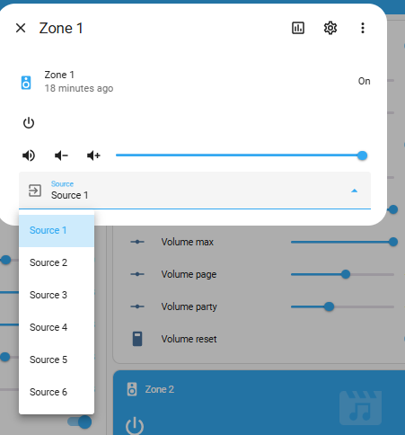

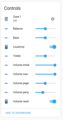

@sprocket-9 Thank you for this integration. I just recently added a Concerto G. I am missing the Source option for my Zones. Any ideas?
2025-01-23 17_33_12-Settings – Home Assistant
@sprocket-9 NM. I found the setting once the zone is tuned on. Thanks again for this great integration!
