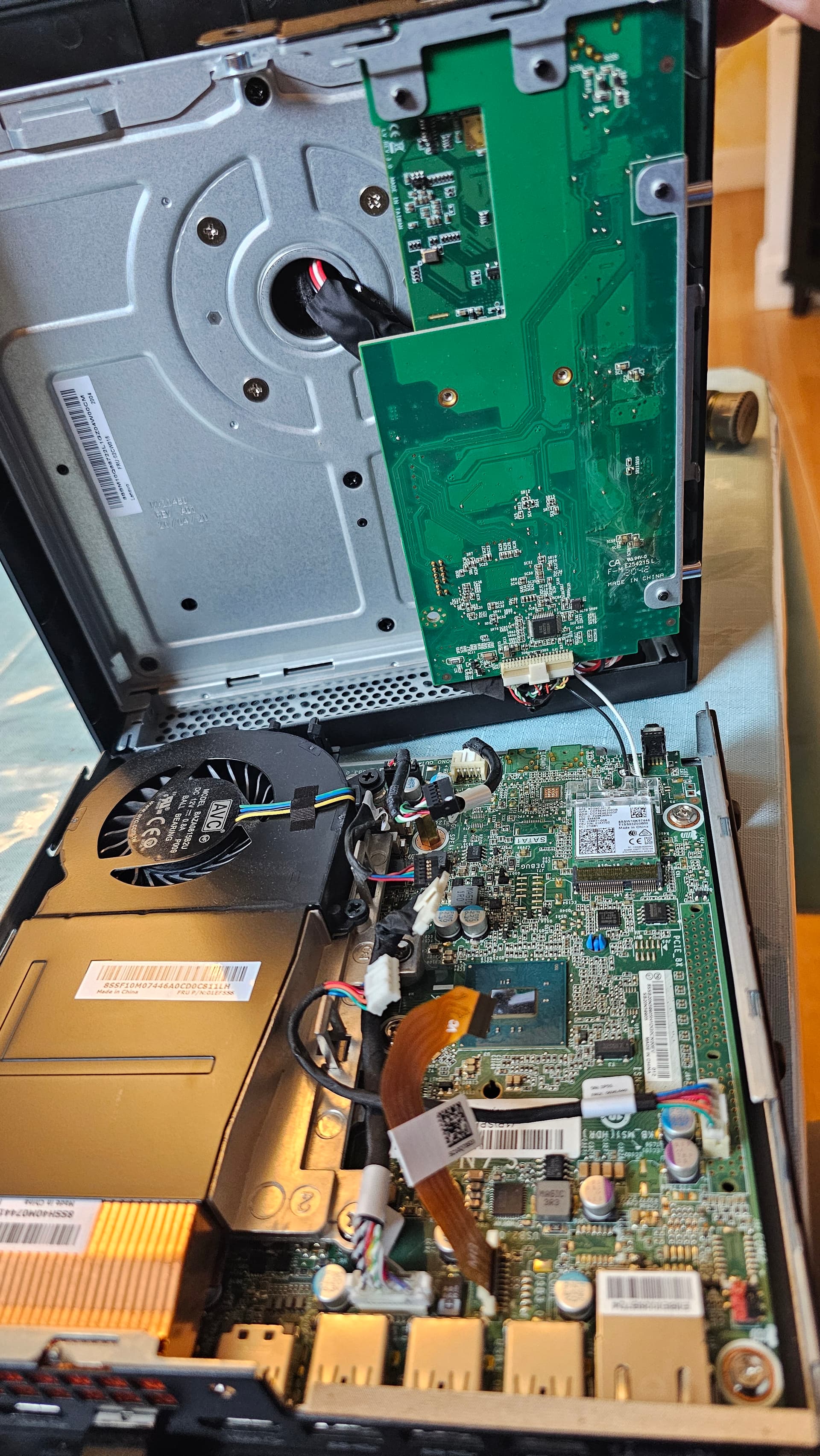

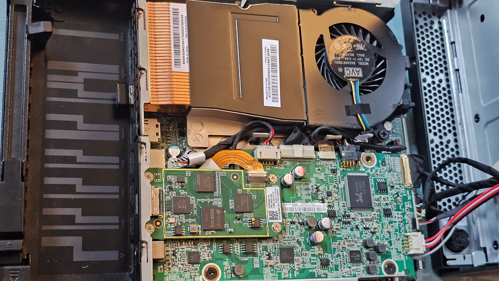

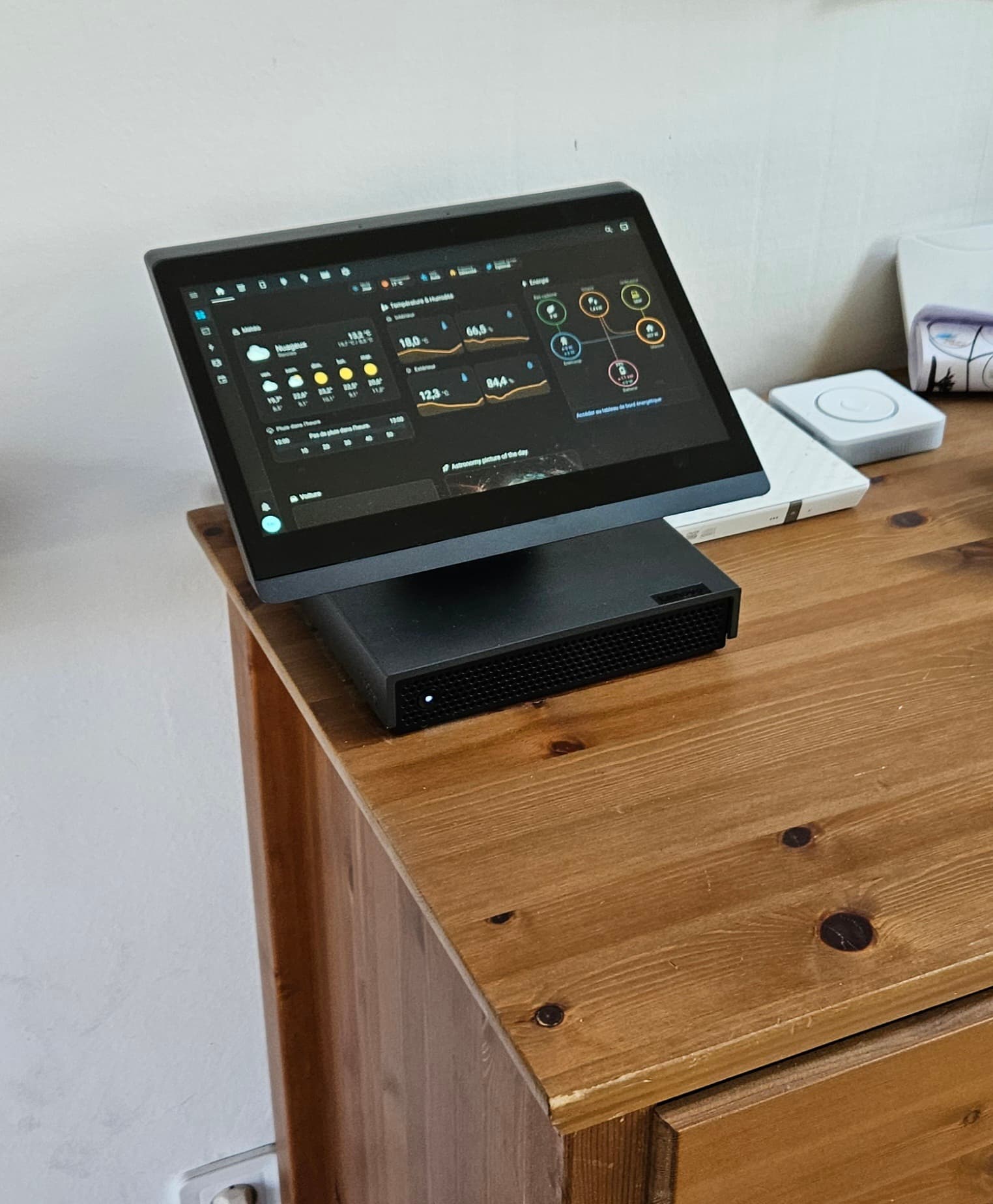

Lenovo ThinkSmart Hub 500

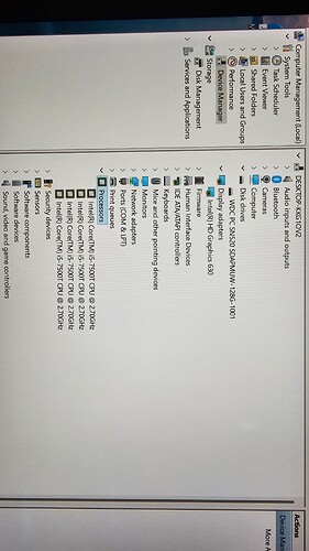

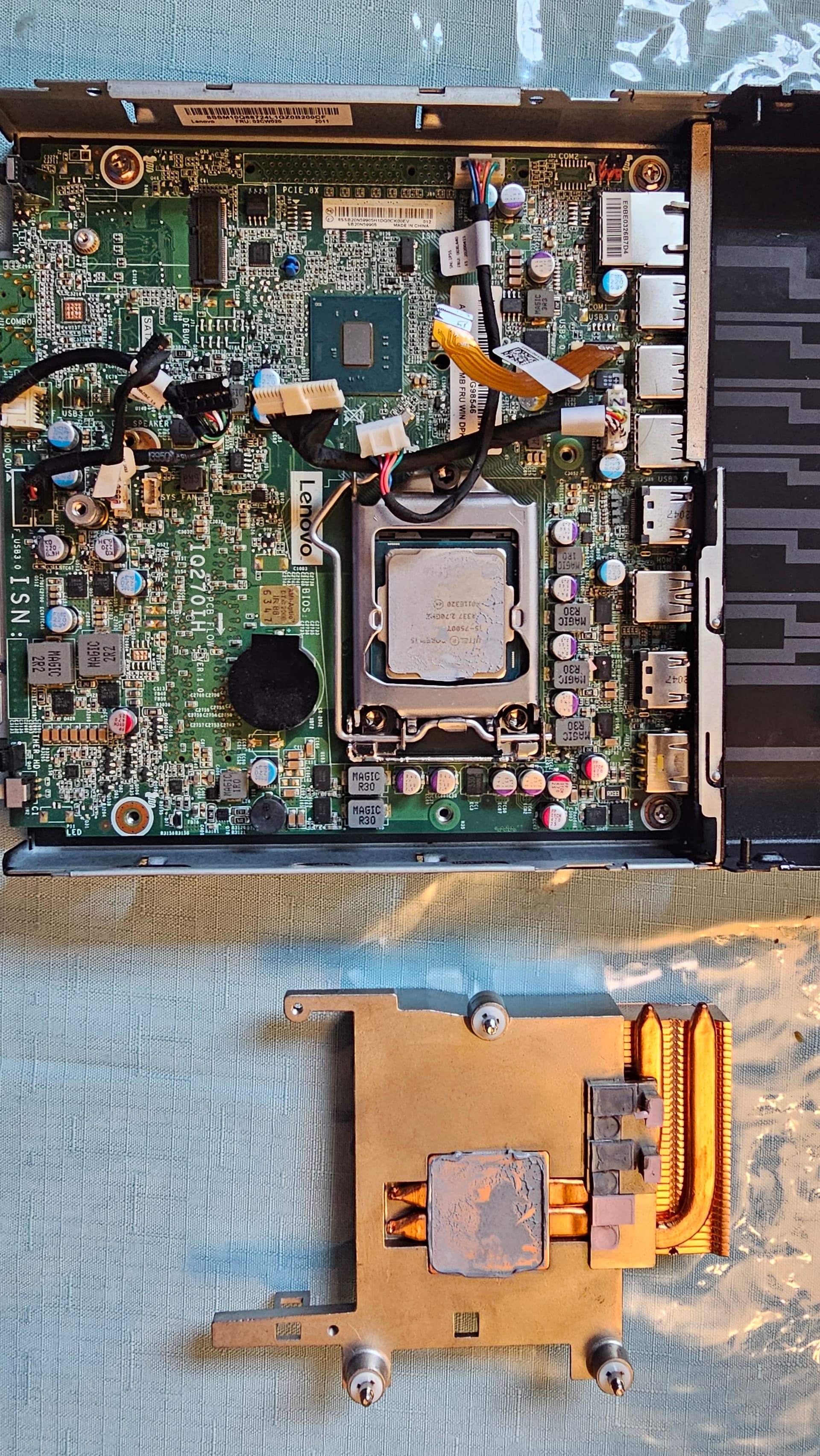

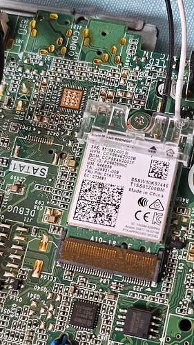

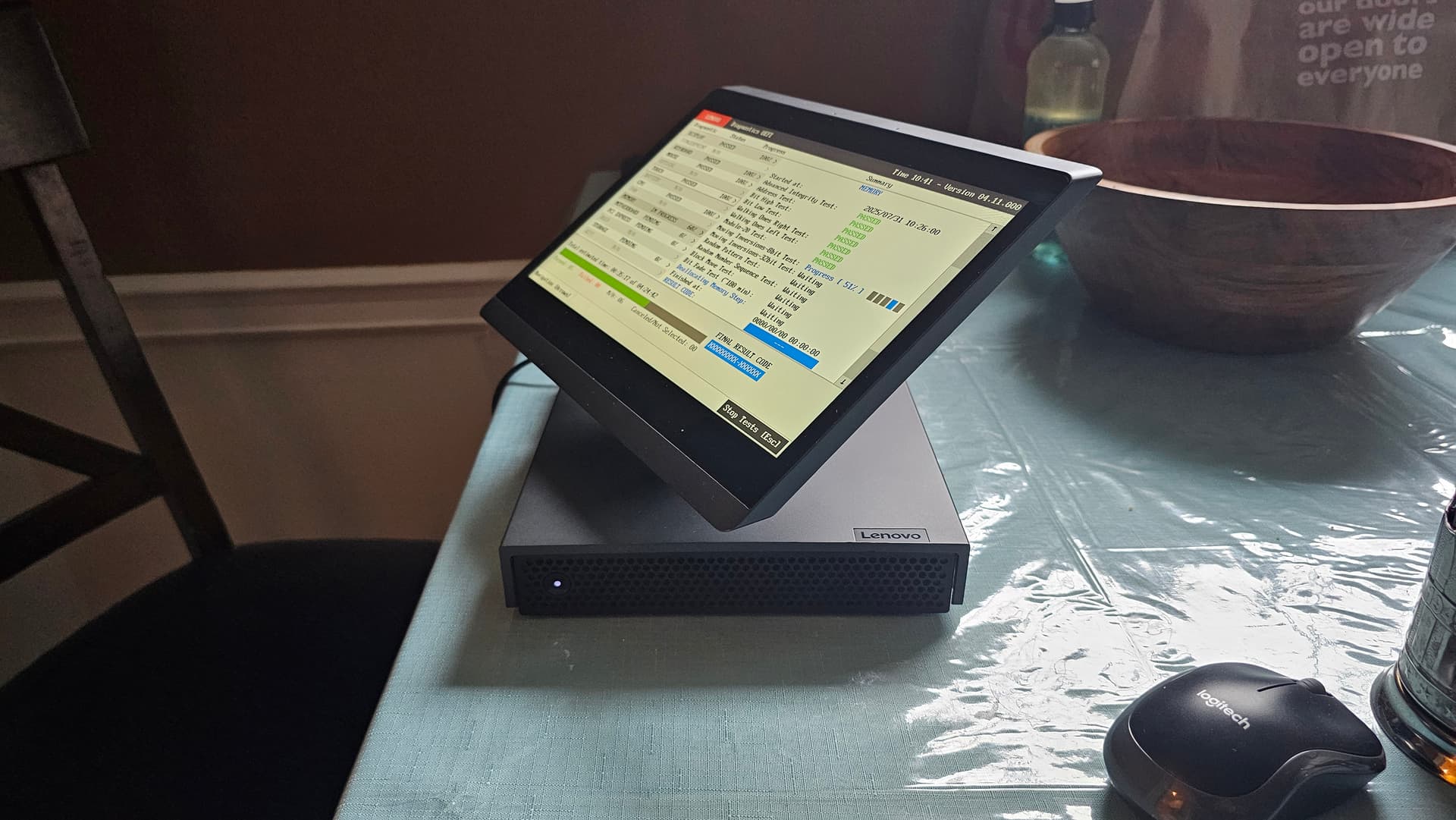

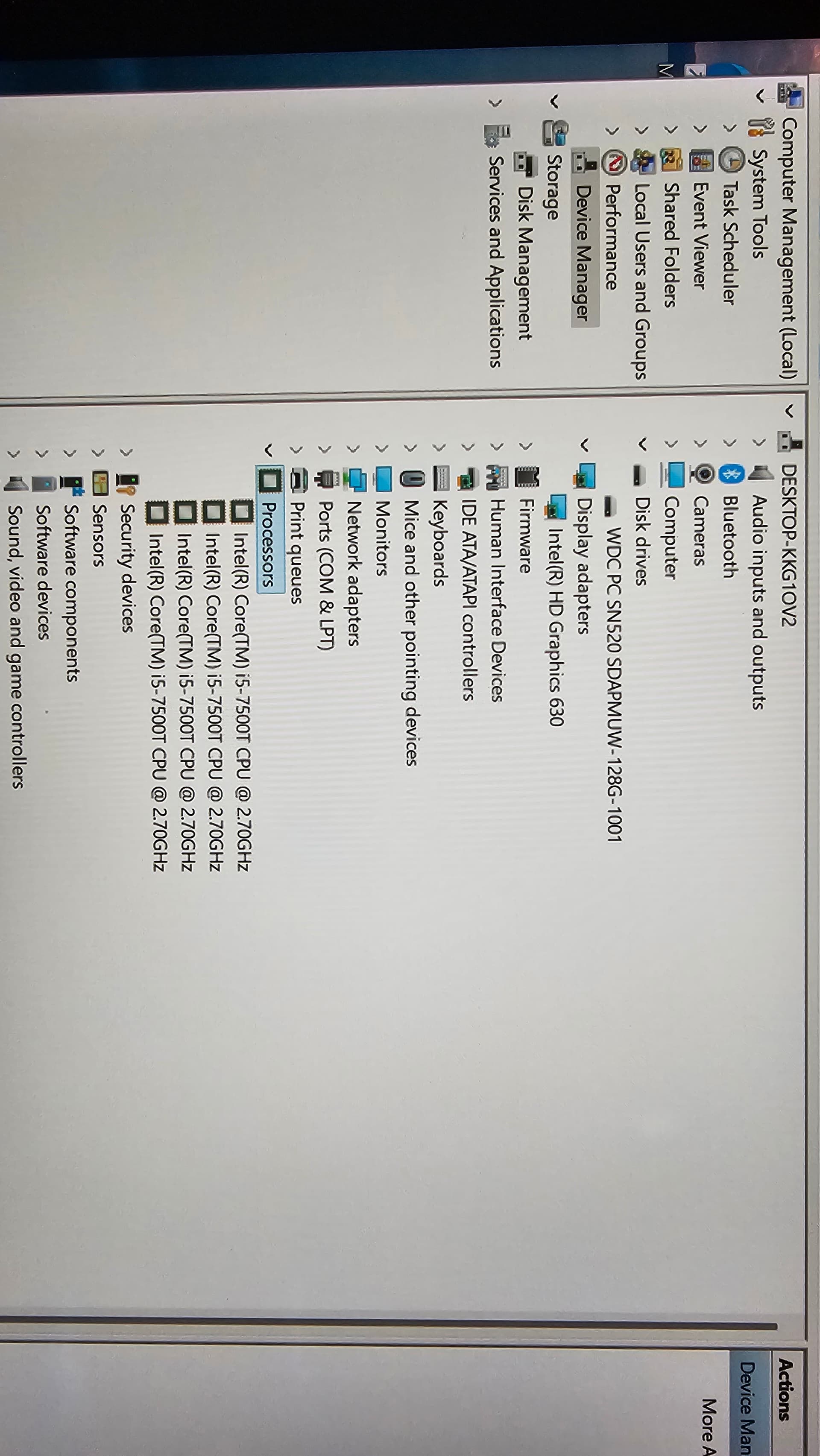

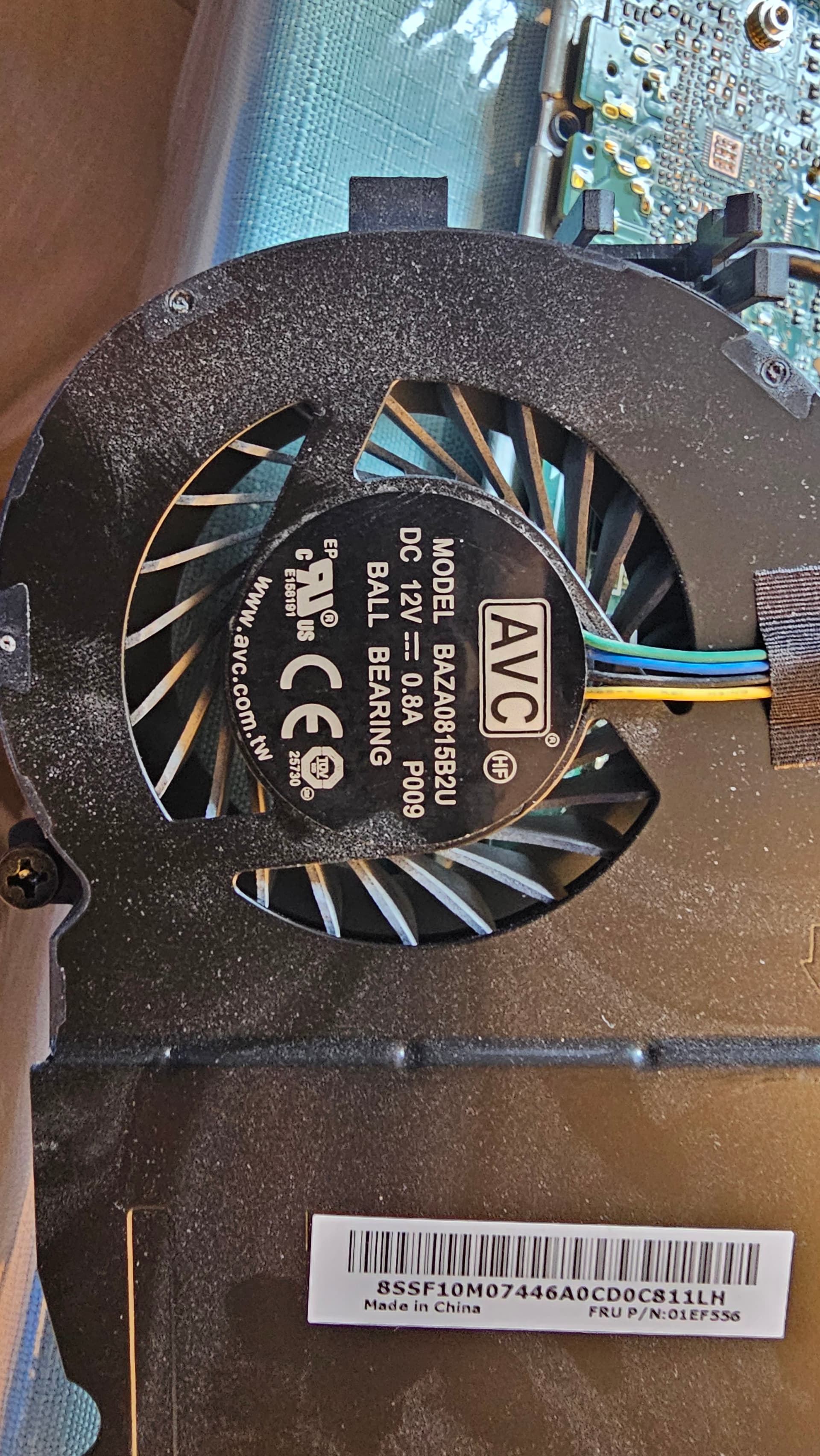

New addition to my homelab.
Mostly will use like HA dashboard and remove management for Dell servers.

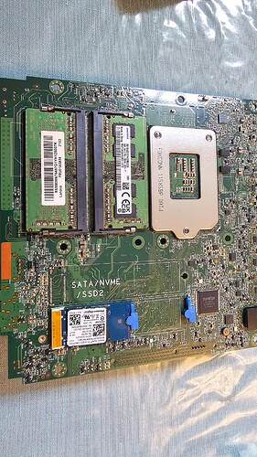

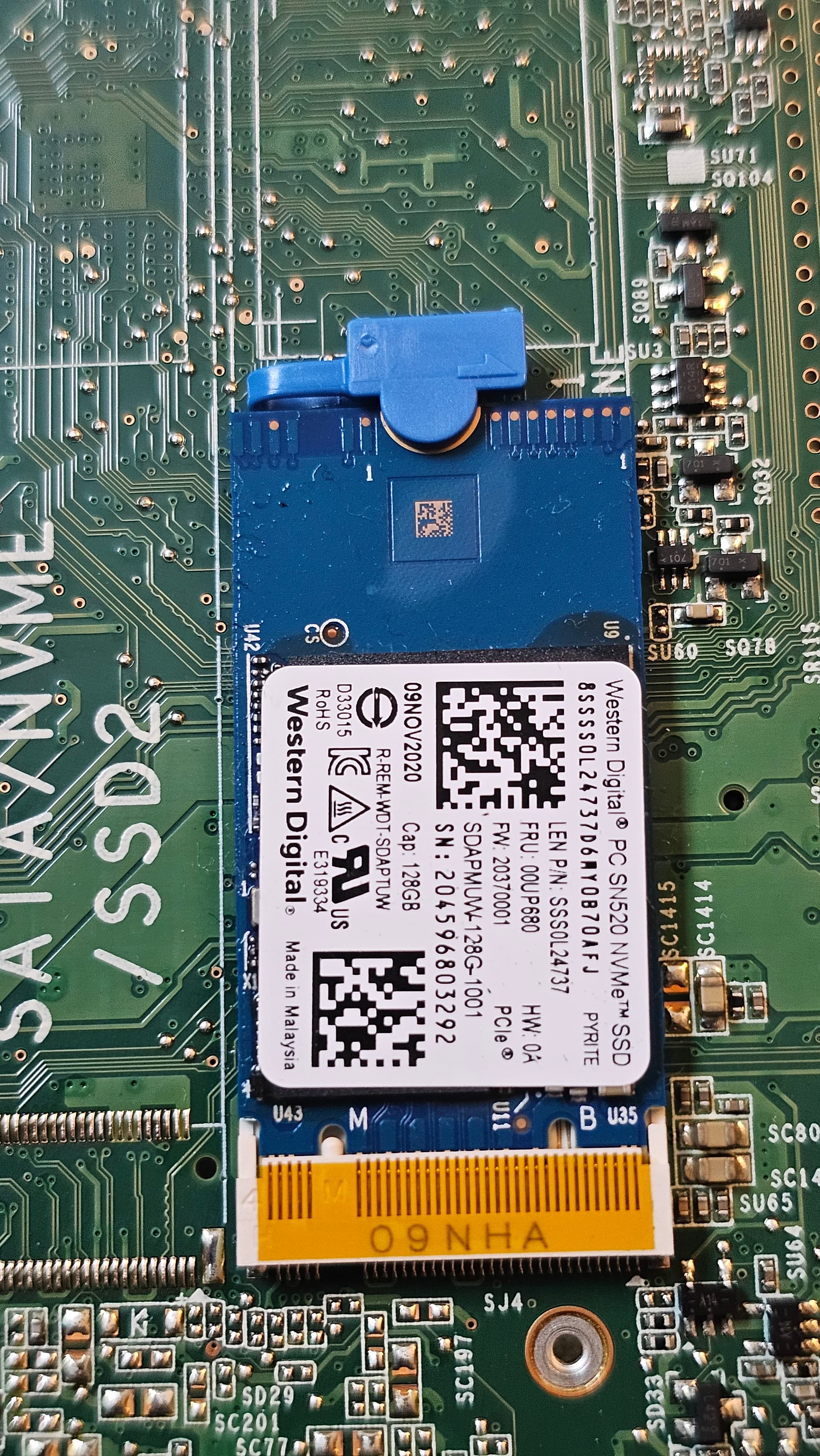

Pros: easily to obtain, cheap, room to upgrade (CPU, RAM, NVME SSD can be upgraded).
Cons: to nice to be used under HAOS.
Useful:

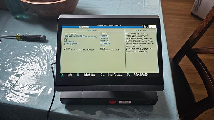

  • touchscreen work even on BIOS. (But not inside diagnostic tool)
  • really nice cable management.
  • built-in mic and speaker.
  • HDMI IN. (No CEC).
  • Wi-Fi, BT. (Can be turned on in BIOS)
Thermal interface (thermal paste) was in good condition.
P.S.: IDK how hide pics under spoiler. Can’t find that option on mobile phone editor.

The only inconvenient I found is that you can’t stop the fan when CPU is low temp.
