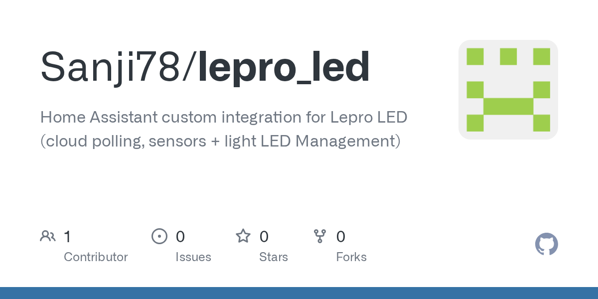

Hi all,
below my integration for Lepro LED:

@StefanoGiu Note that your github project Issues is disabled for anyone but collaborators.
Yes… project is locked and won’t be mantained anymore because issues were full of people pretenting fix without even saying thank you… I will keep the work I will do for Home Assistant for my personal use…
