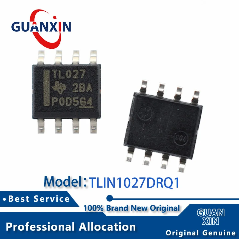

I have cheap LIN from Ali with 1021 and it is not working, but
when I replaced 1021 with 1027 everything is working (even without diode and resistor)
Where do you buy 1027? any link?
Ali:
Hi - regarding the low cost LIN UART adapters with the TL1021 that do not work. I think there maybe a workaround by creating small glitches to keep the TL1021 active on the LIN bus while not impacting the overall slow transmission. I hope to try this with my real LG unit soon when I get out to it. But for now I have a proof of concept documented: here.
Confirming successful operation using TTL LIN UART adapter with workaround I’ve documented here
