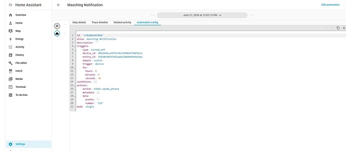

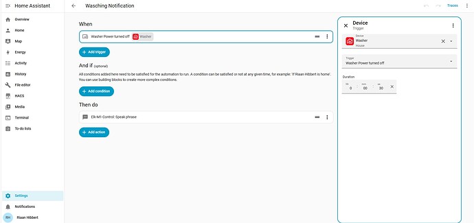

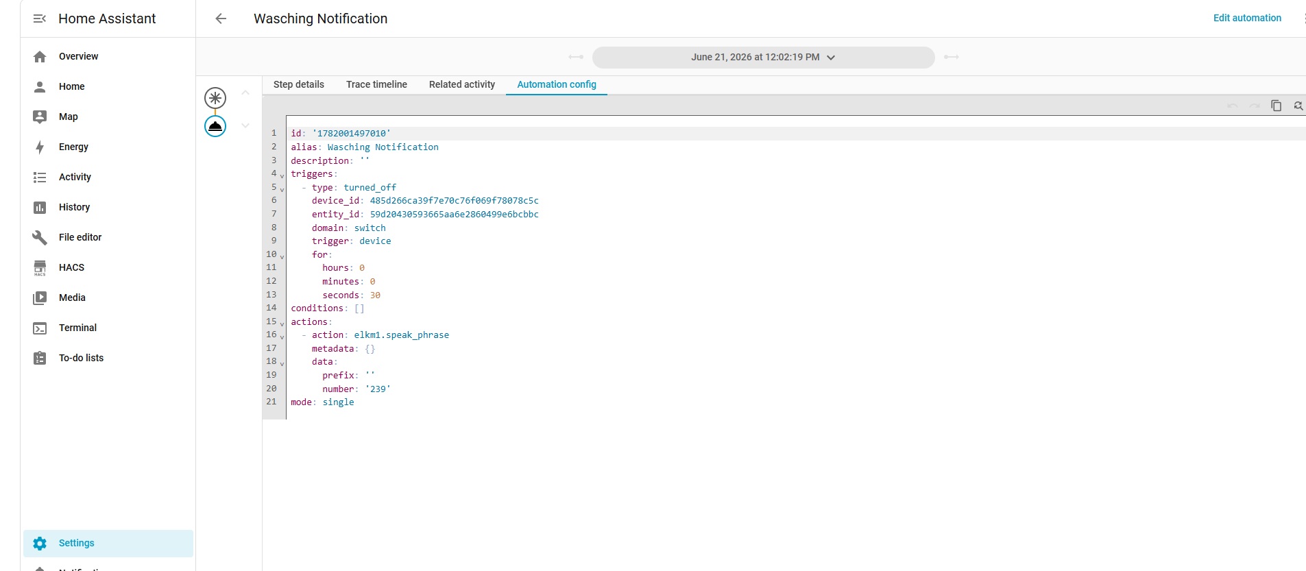

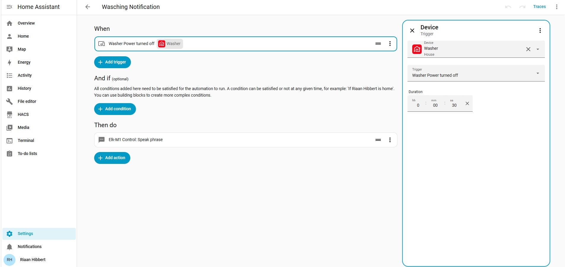

It is visible in the HA dashboard and updates as the washer changes, but nothing happens in a simple program, what i want to achieve is this:
Machine finishes cycle which triggers my ELK M1 to announce
If I run action in the automation it announces in my Elk

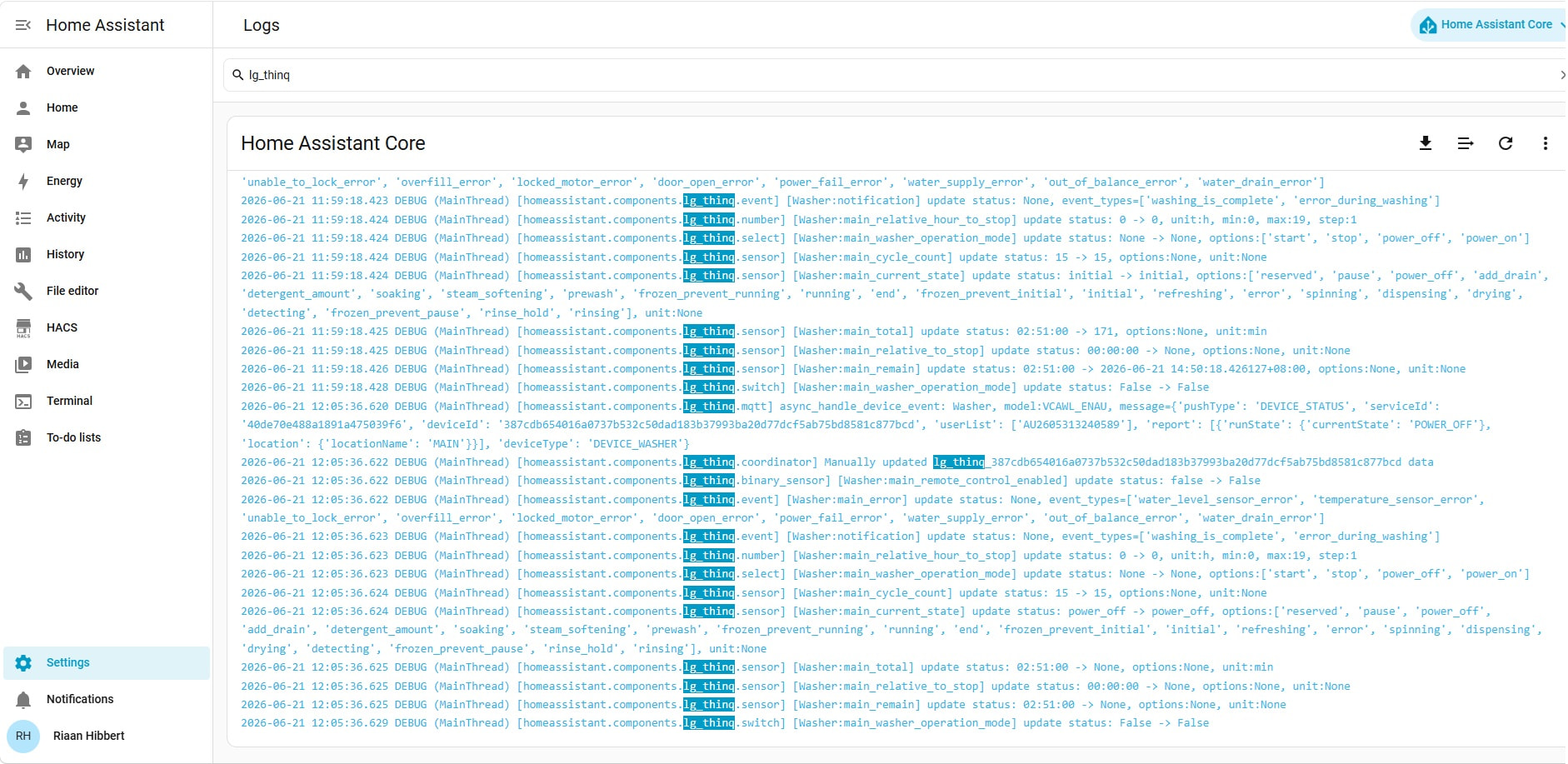

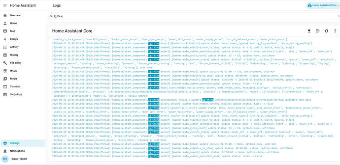

Took a screenshot of logs

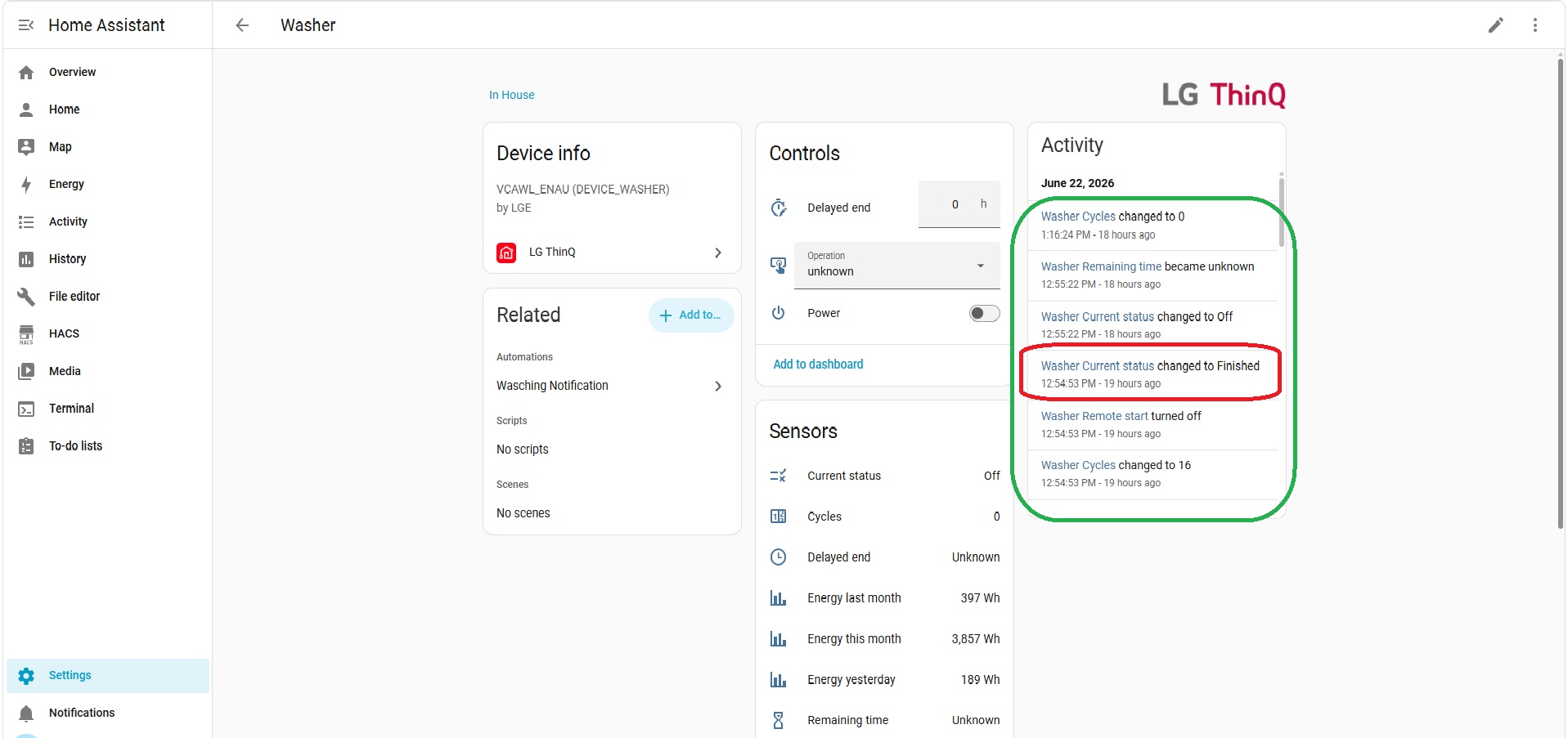

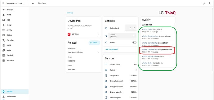

Check the trace timeline for the automation - it'll tell you exactly what happened. Also, check the Activity page for your machine. It'll also show you all the changes it went through without needing to enable debug logs.

My machine takes something like 15-30 minutes to power off after it's done washing, so I'd never base an automation on power off if I want to be notified immediately when the washing is done.

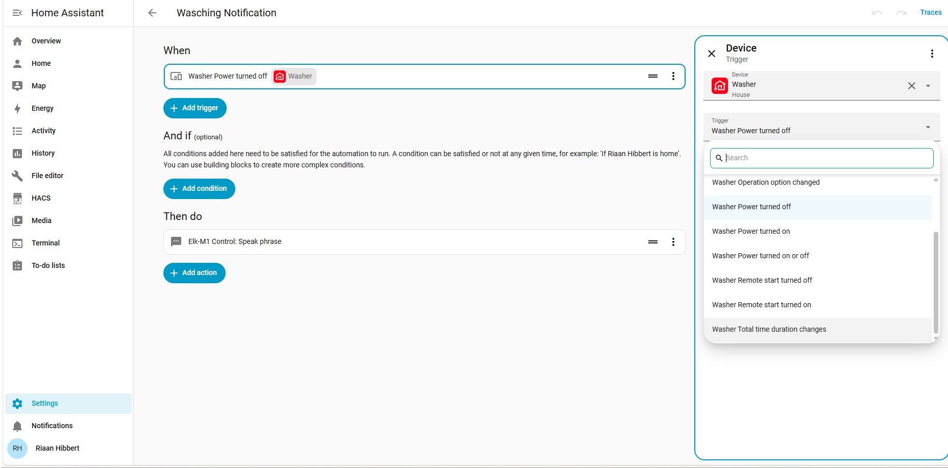

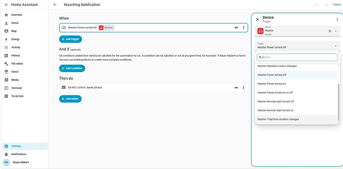

it doesn't give me the option of "Cycle complete " or something similar
As I said earlier, check the Activity page for your washing machine. Do you see an event fired when laundry is done?
In the device page, look for an event entity -
Like this ?
How do I incorporate those events into a trigger? Apologies I'm very new to HA
You have a "Current Status" sensor. That's the entity you should use in your automation. Choose "entity state" as your trigger, select the "Current Status" sensor, and then select "Finished" as the state.
