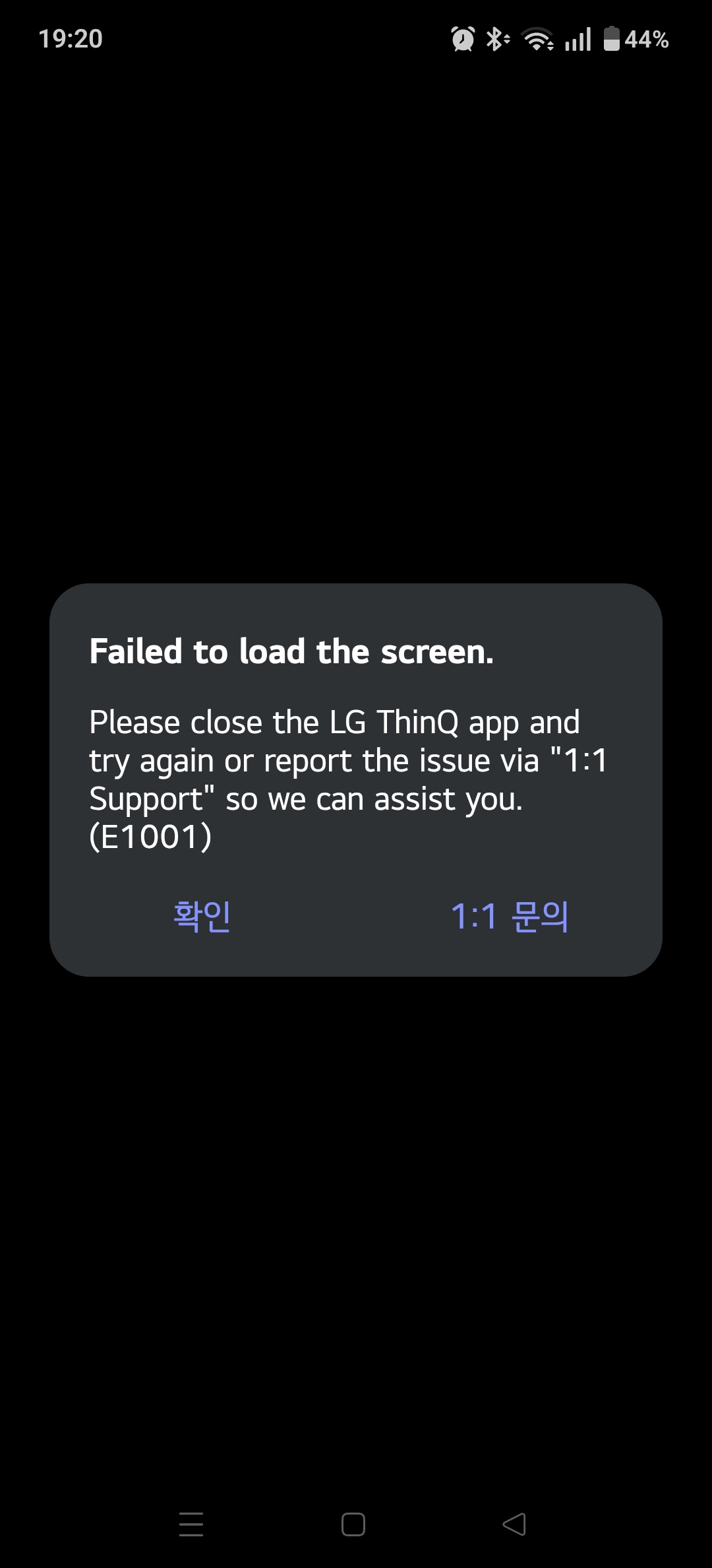

Moreover my app is not working, it says something like cannot connect to network. I logged out, and now all appliances are gone and gives a "failed to load the screen". But LG status page says no outage.

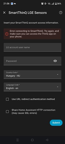

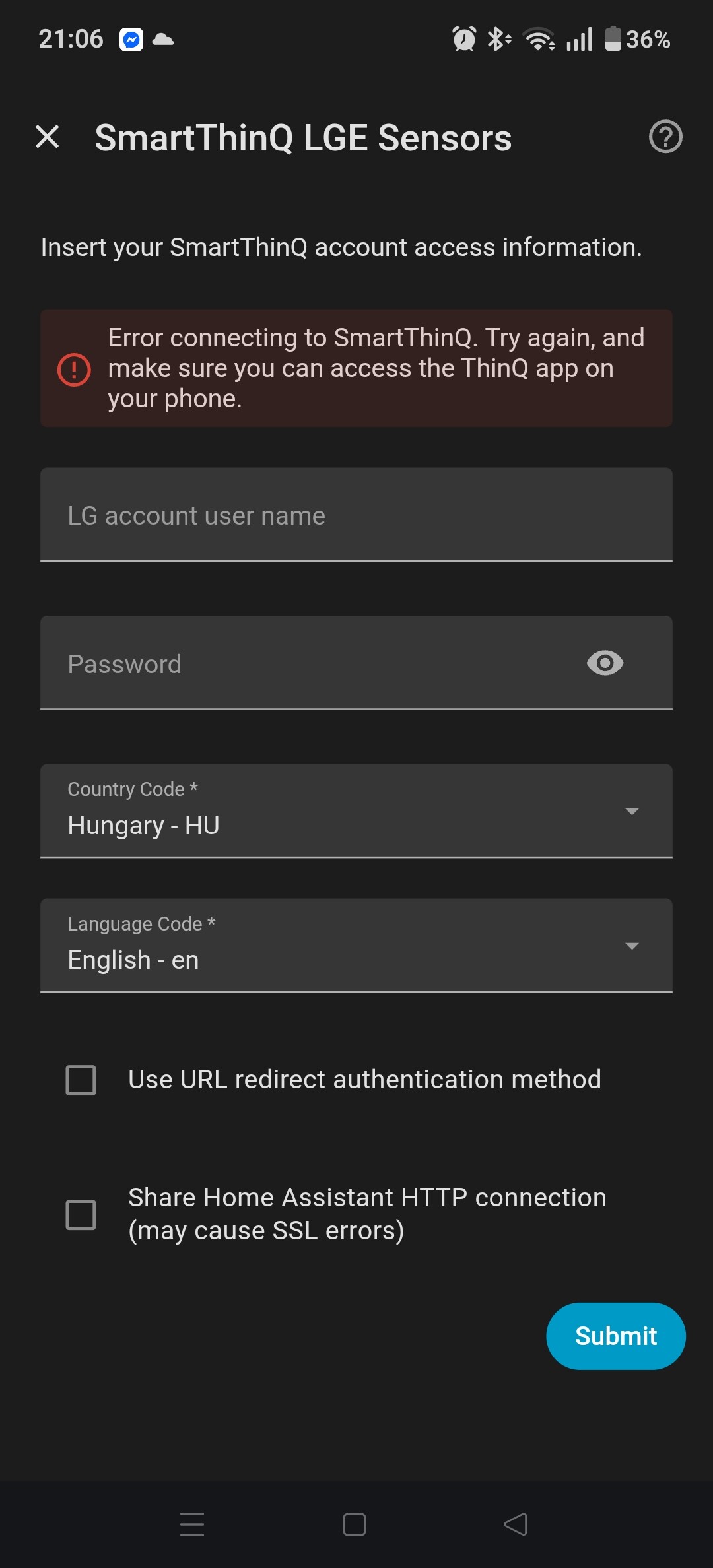

Same here, after HA restart lg SmartThinq stopped working, reading didn't help, also the LG SmartThinq app doesn't work.

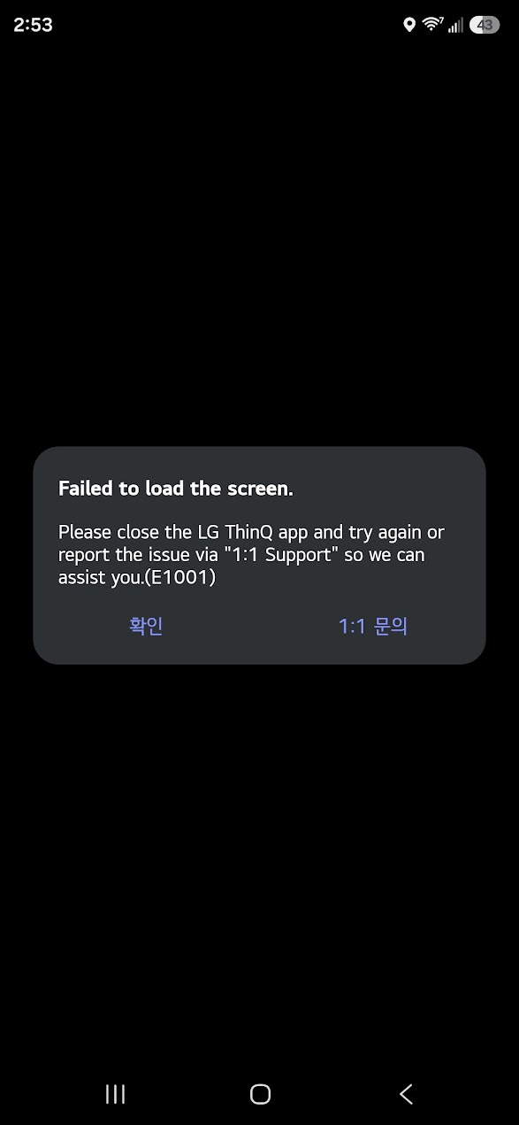

I. Have issue with LG thinq as in image
i have the same issue the oficial integration is working
but the hacs is not also i cant even connect with the app
it says there is a problem with the server and i get blank screen

Has anyone managed to contact LG customer support? I have error E1001 and it is not possible to ask for support.

I had the same issue a few days ago; I was using the Smart ThinQ Sensors HACS integration for many months with our frontload LG Washer and frontload LG Dryer (US4000 models, IRC). Restarted HA and the STQ Sensors app no longer would allow me to log in with my account credentials (not social media, but a username and password). Same issue as others. Kept telling me the credentials were not valid, or that there was an error trying to connect, and that I should check the app on my phone to make sure there were not any new terms of service that needed to be accepted. Checked the phone app, and not only were there no new service or privacy terms, the app could no longer control the appliances (they were present in the app, but were not connecting with the actual physical appliances). So the LG Cloud was clearly malfunctioning..or so I thought. I tried clearing cache on my phone app; force closing it (Android) and restarting the app. Nada. Nothing. Zilch. Started two parallel searches for additional info: 1) Googling to see if there was a customer service phone numb;er for LG (there was and it was horrible....one of the worst CSR experiences I've had in years...more abou that later), and 2) just a search to see what the issue whether others had been having the same issues with not being able to log in to the HACS LG Smart ThingQ integration. And it was then that I discovered there was actually an "official" HA LG SmartThinQ integration, albeit with fewer entities exposed than the HACS one.
To make a really long story short, I've given up on trying to use the SmartThinQ Sensors HACS integration, because it has proven to be too unreliable, and I've spent far too much time trying to get it to stay logged in and connected to my washer and dryer. While there are fewer entities exposed in the HA Official LG Smart ThinQ app, using the PAT (personal access token) that is availalbe from the LG Developer site (note: you need to register separately for that site...but a tip, you can use the same username and password, and LG apparently doesn't care...it just makes things a lot simpler to log in if you need to get a new and different PAT). For me at least, the pain and time and trouble trying to get the older HACS integration to stay connected just wasn't worth my time.

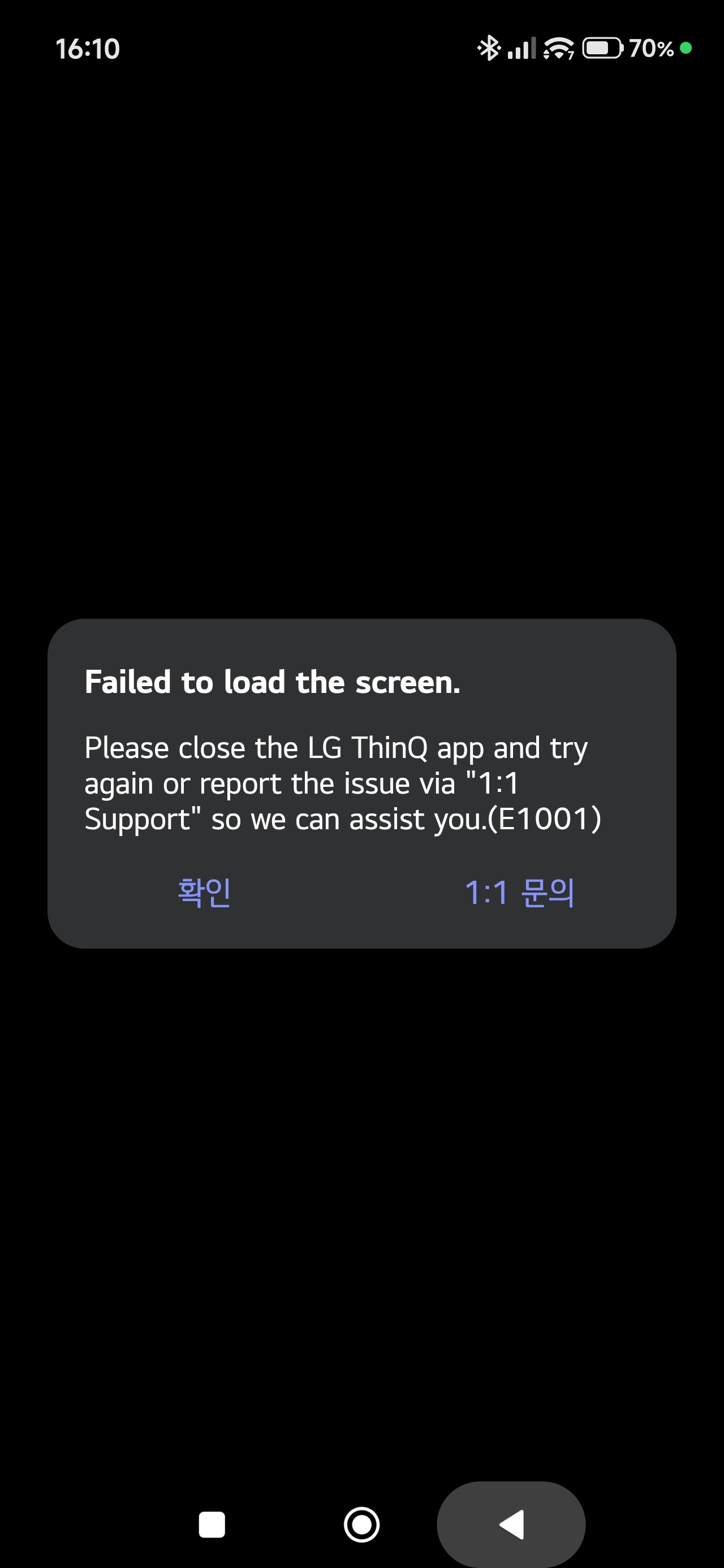

I have the exact same issue as you and others with the Korean error. None of my devices are there anymore and it asks me to register my phone number. This goes beyond an HA issue, but an LG issue. It looks like it's been an issue for over a week, not a good look for LG. Anyone have any fixes yet or status from LG?
Edit: And now, magically, it works for me again. Their servers must've been down.
Edit 2: Well, the entities are greyed out again. No clue what LG is doing here, but it's impactful beyond just Home Assistant I imagine.
Edit 3: I started a chat with LG customer support and they claimed that there was an active outage impacting log in as well as usage of the mobile app. Hopefully that gets resolved soon.
Edit 4: For me, LG's outage has ended and after reloading my LG integration, all of my devices work again and are enabled. Hooray! Hopefully this helps others.
