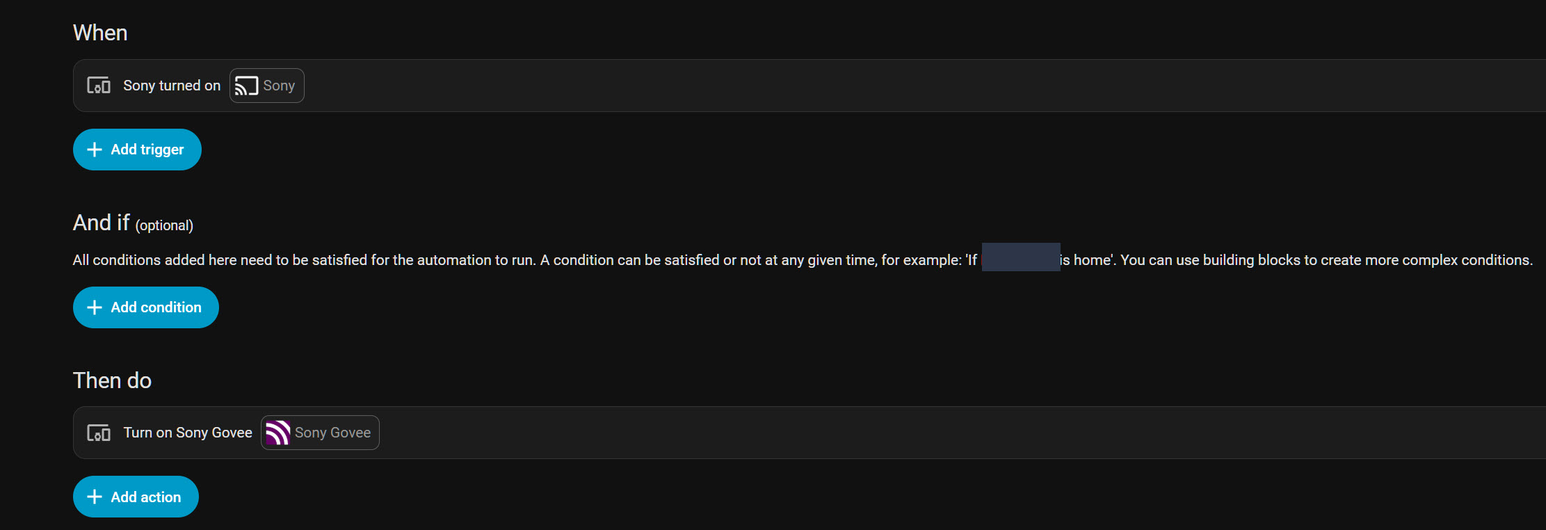

Here is a screenshot of the automation. I didn’t think we needed a condition, correct?
Why is the Sony device a trigger in this scenario?
Why not build a trigger with LG OLED media status?

I’m trying to do the same on both a Sony TV as well as an LG TV. I finally got the Sony TV and Govee to work. I had to use “BRAVIA XBR-43X800D” rather than Sony. I also had to use “Sony Govee Power Switch” rather than just Sony Govee to get it to work. I will try the LG next.

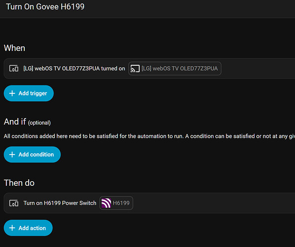

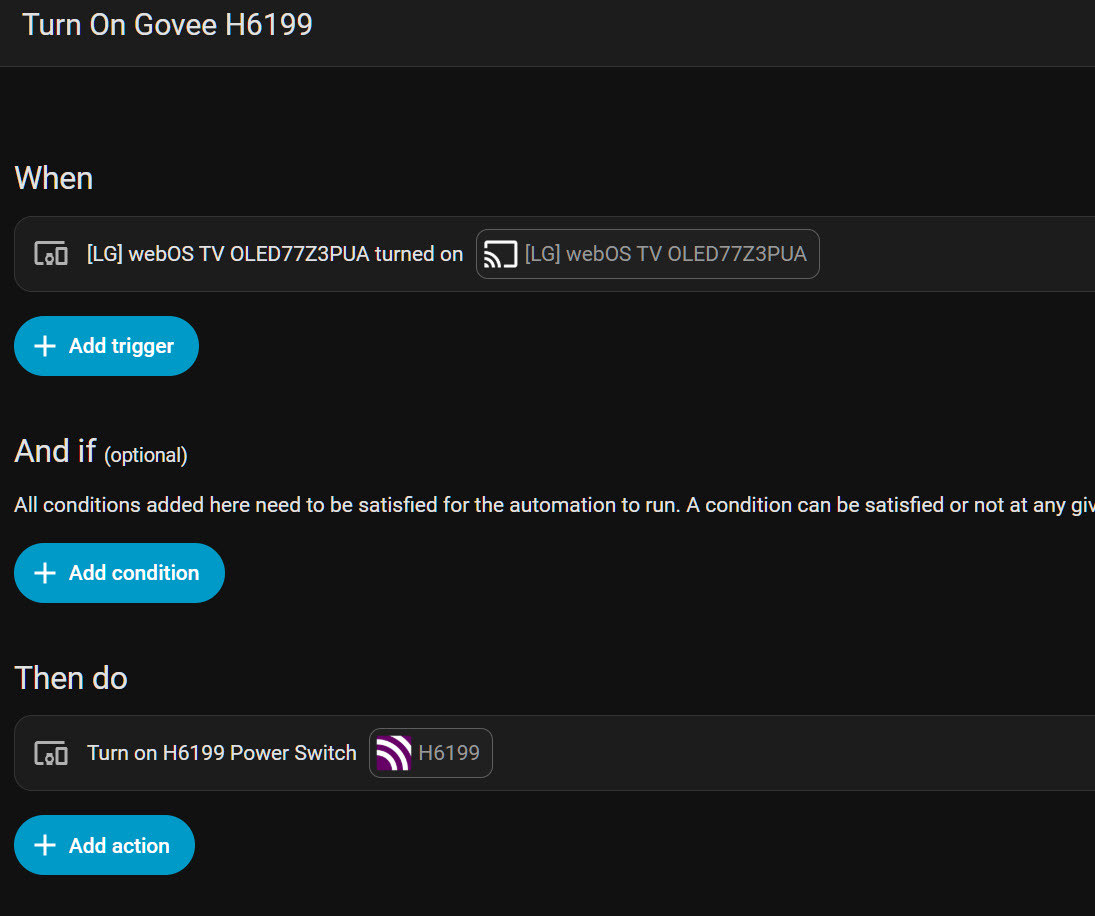

The LG with Govee automations is not working when doing the same as I did with the Sony TV that worked. Here is a screenshot of the LG automation:
Any thought of what might be the reason it won’t work? Maybe someone that has an LG TV with automations working.

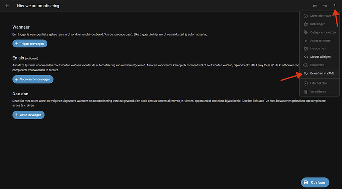

You should be able to view it as YAML by clicking the three dots in the upper right corner.
It is easier for us to read the YAML than a screen shot of the GUI.
@s795723 please don’t ignore what Wally is trying to tell you. You will get more effective help on this forum when you post your automation in .yaml format.

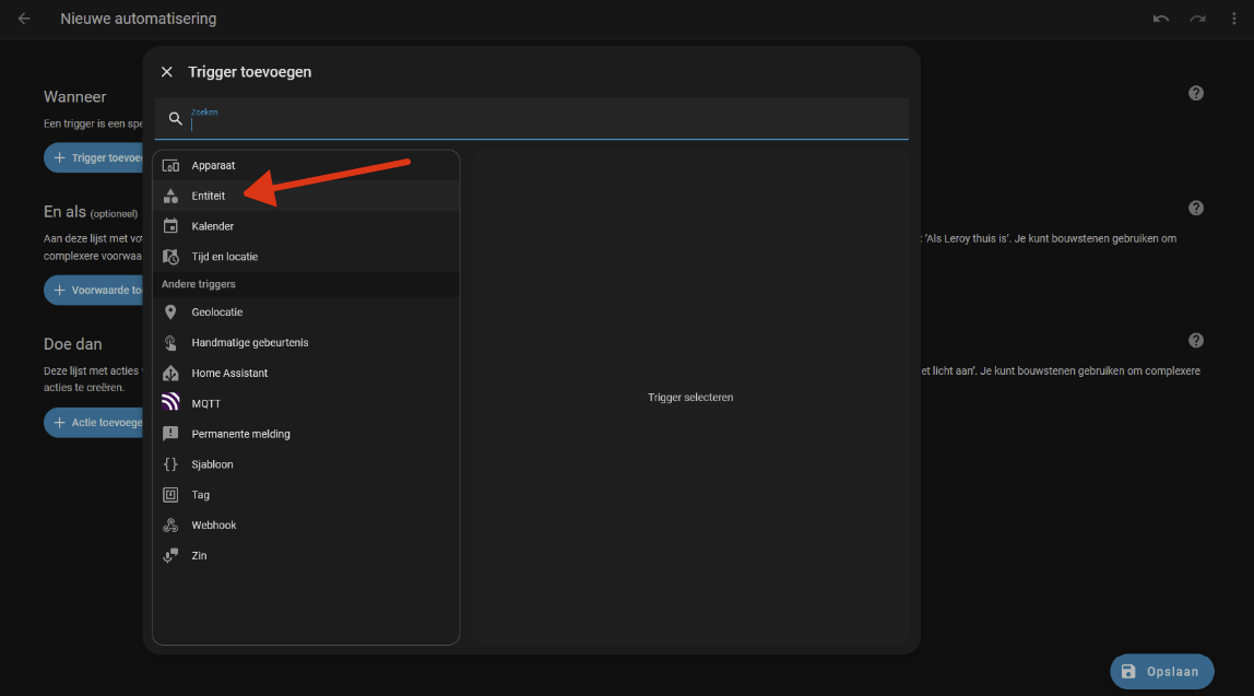

In your Home Assistant automation, you can navigate via the below route to the .yaml code of the automation. Copy (ctrl+c) the code.
On this forum when you’re typing a new post, use the below option to paste (ctrl+v) the .yaml code.
afbeelding

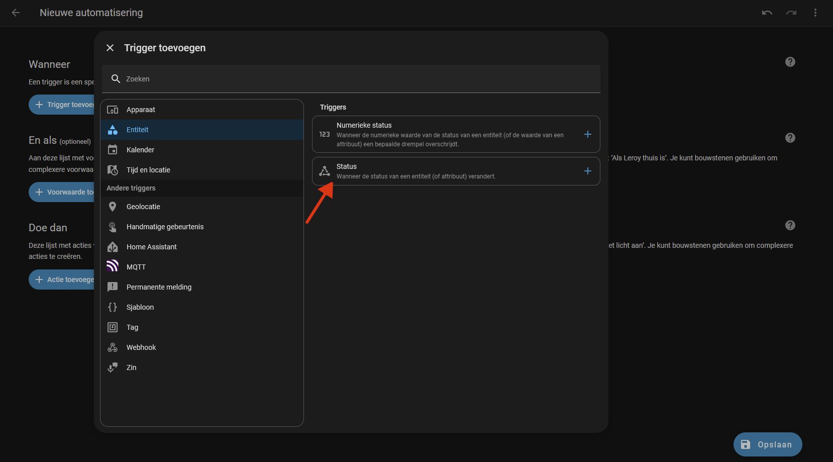

Secondly I am unsure of your trigger.
I would probably use a state trigger instead and react to the state on, which is what my LG TV report when it is on.
Not sure what a “state trigger” is but I left everything the same except adding the entity name and it seems to be working now. I’ll test for a couple of days. I did notice that the LG TV is indicating “unavailable” on the Home Assistant app even though I have it set with a static IP. Anyone know what might be causing the “unavailable” issue?
