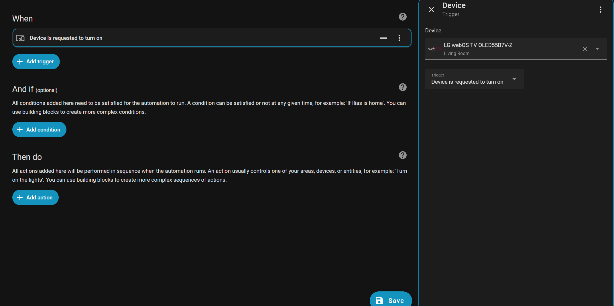

Was a little confused on the automation, but figured it out. It’s documented on the integration page.
## Turn on automation trigger
To turn on your TV, you need to create an automation. You can create an automation from the user interface. From the device, create a new automation and select the Device is requested to turn on trigger.
Actually looks better now since I was using a dedicated button to trigger a script, and now the script is integrated with the media_player entity.
Very cool. Thank you!
Hello, everyone! Thank you very much for your messages. I had the same problem, and even though I had read the release notes carefully, I didn’t understand what to do!
For my part, I just added the following automation:
- id: 'xxxxxxxxxx'
  alias: Salon - Allumer la télé du salon
  description: ''
  triggers:
  - device_id: xxxxxxxxxx
    domain: webostv
    type: webostv.turn_on
    metadata: {}
    trigger: device
  conditions: []
  actions: []
  mode: single
And it works again like before!
