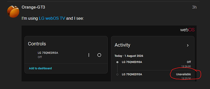

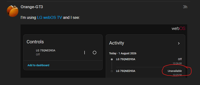

I’m using LG webOS TV and I see:
DeLorean
(Loryan Strant)
August 1, 2026, 8:25am
5
It isn’t Unavailable it is Off. Look at the status at the top left under Controls and the latest entry in the Activity.
My post was not supporting your theory.
DeLorean
(Loryan Strant)
August 1, 2026, 10:33am
7
It was unavailable, most likely when you turned it off:
The 10 second difference between states.
That is the problem.
