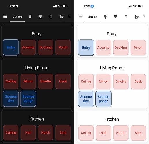

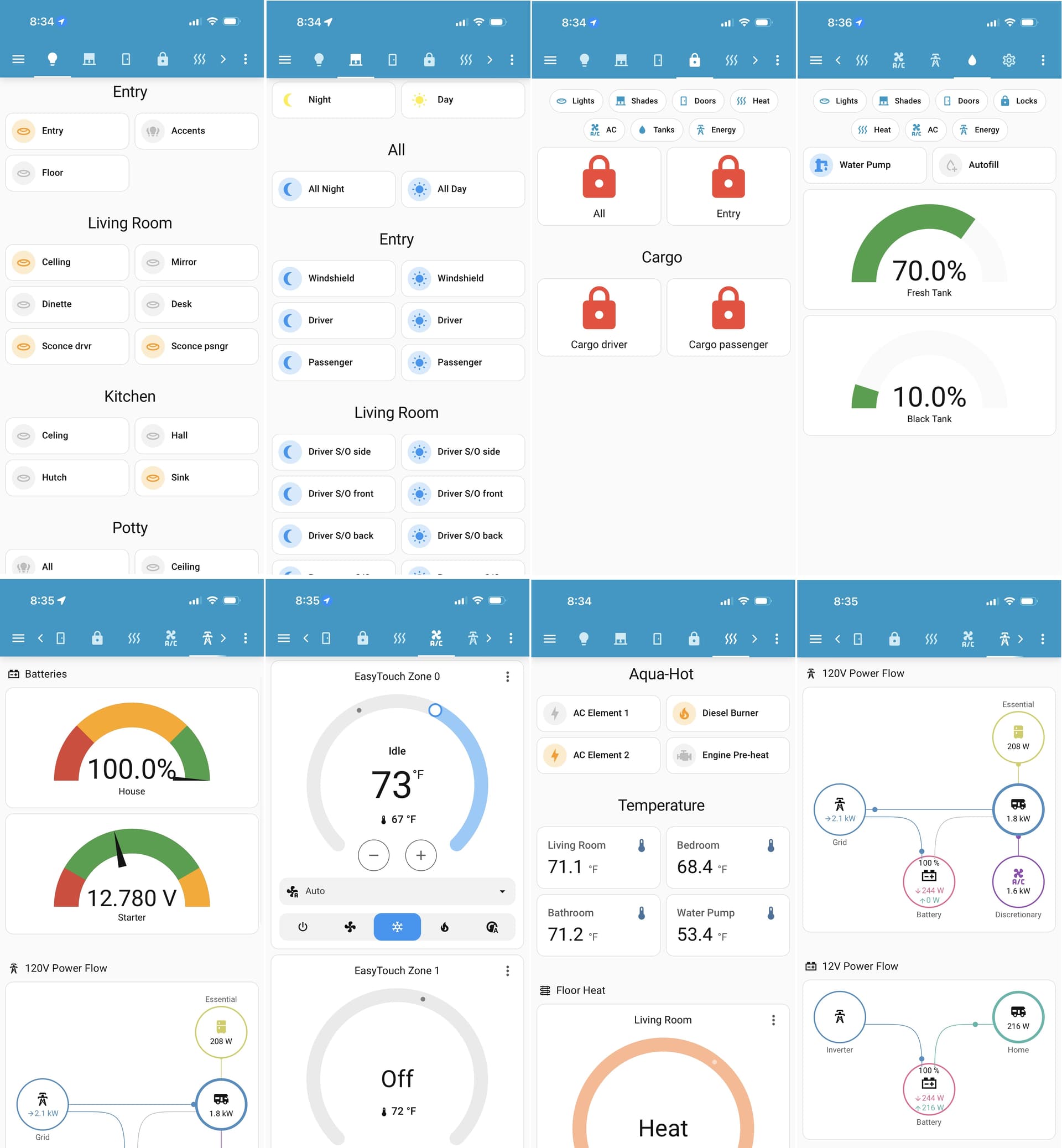

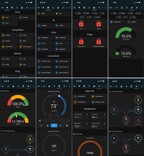

I’ve created a couple of apps (add-ons) that enable Home Assistant to easily work with any RV-C–enabled RV. I’ve been running it myself for about a year and I think it’s finally ready to share. The screenshots below are from my personal dashboard using LibreCoach and a few other HACS integrations.
Check out https://librecoach.com/ to learn more about it and let me know what you think!
