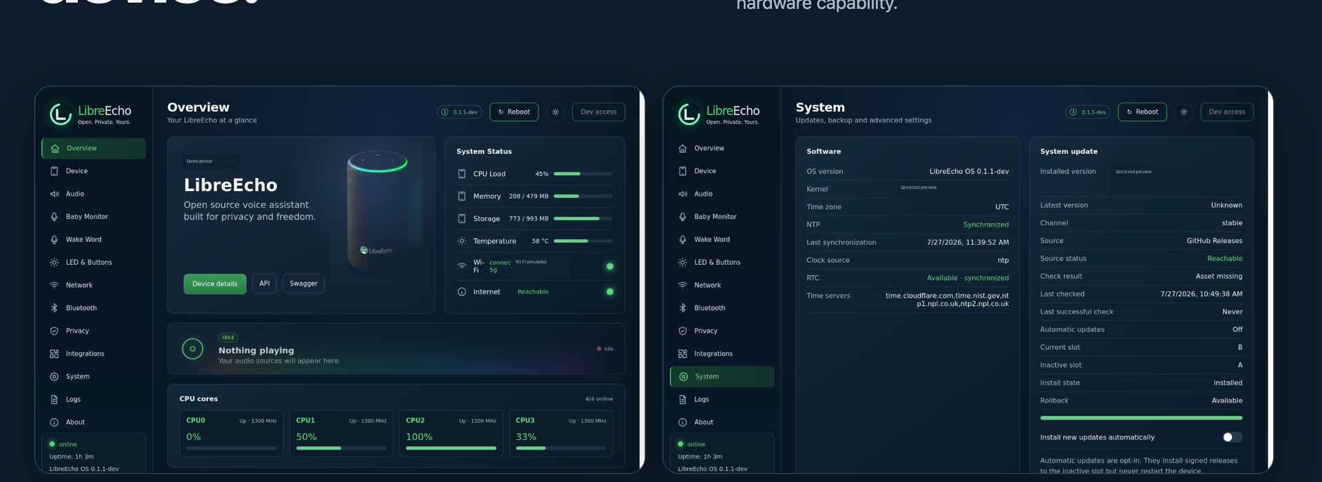

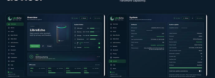

I’ve been working on a project called LibreEcho which aims to turn the full-size Amazon Echo 2nd Generation into a genuinely owner-controlled, local device.
Rather than building an Alexa skill or depending on Amazon’s cloud services, LibreEcho replaces the software stack and boots its own Linux 6.1-based system on the Echo’s MediaTek MT8163 hardware.
The long-term goal is to make these devices useful as open Home Assistant voice and media endpoints, rather than throwing perfectly capable hardware away.
What currently works
On real Echo Gen 2 hardware I currently have:
  • Linux 6.1 booting reliably
  • Boot/recovery and A/B slot handling
  • Wi-Fi
  • Bluetooth A2DP playback
  • AirPlay playback through the original Echo speakers
  • The original speaker/codec hardware under Linux
  • LED ring control
  • Microphone capture
  • Local wake-word detection
  • Local TTS
  • A local Web Control Centre
  • Signed A/B OTA update infrastructure
  • Local assistant/service integration experiments
The whole thing runs on the Echo itself rather than requiring an additional Raspberry Pi or external controller.

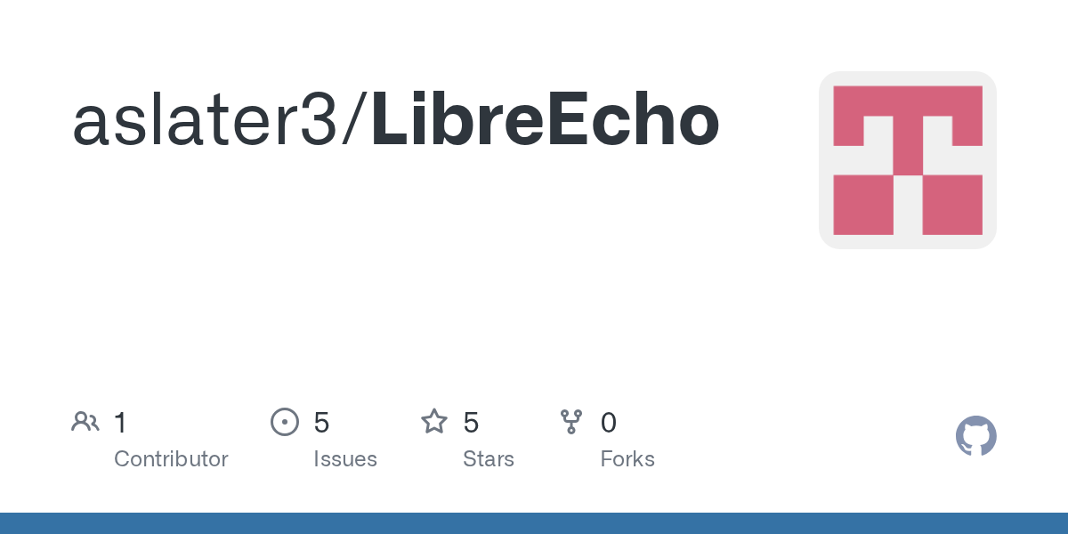

Project / source:
Website / current project status:

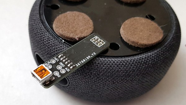

I am willing to destroy an echo gen 2 for even the hope of this. I haven’t bother tearing an echo apart the in the past but can do whatever. I see 6 pins on the bottom covered by a rubber cap on your currently supported model. Can I just use those to connect or are there uart/usb pins i need to soldier to? I’m still trying to figure out the initial flash after looking at all your stuff for an hour.
Ok, i think it is just a hidden usb port on the bottom now.
Nice! Yeah so those contacts on the bottom are the USB interface. I want to get to the point, if possible, where you dont have to disassemble and just need a jig of some kind so sit the echo on and you can install that way. At present the only validated way is to short a pin on the eMMC chip to force it to drop to BROM mode. Then you run the amonet based installer.
