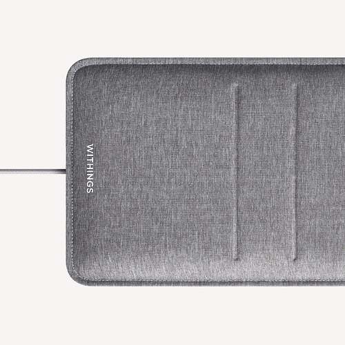

If you can afford it: I use the Withings sleep mat. That uses air / air pressure and is sensitive enough to detect breathing. So it does way more than just detect if you are in bed. It alerted me and my wife to sleep apnea.
We have two of those here, great product.
