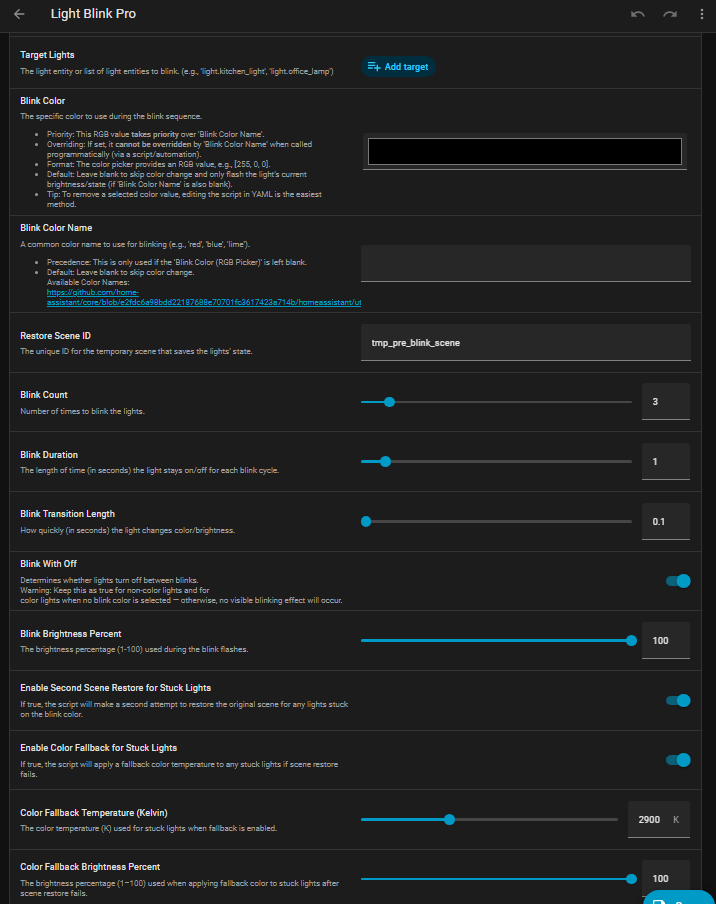

Core Features
  • Essential Blink Functionality: Easily configure lights to flash a specific number of times, at a defined duration, brightness, and transition speed.
  • Alternating Blink Mode (New!): Use the CHANGE action between flashes to alternate the light color and/or brightness, creating effects like color pulsing or alternating colors.
  • Single Required Input: The light entity itself is the only required input. All other values (count, duration, color, brightness, etc.) are optional and will fall back to their default values if left blank.
  • Universal Light Compatibility: Handles blinking for color-capable lights (applying the selected hue) and non-color lights (applying only brightness and timing) as well as simple on/off lights.
  • Flexible Color Selection: Supports choosing a single blink color using either the RGB color picker (which takes priority) or a color name (via text input).
  • Reliable State Preservation: The script automatically saves the light’s exact state (on/off, brightness, color) to a temporary scene and ensures it is fully restored after the blinking sequence.
  • Stuck Light Recovery: Includes logic to detect and recover color lights that fail to restore their original state (a common issue with some light devices).

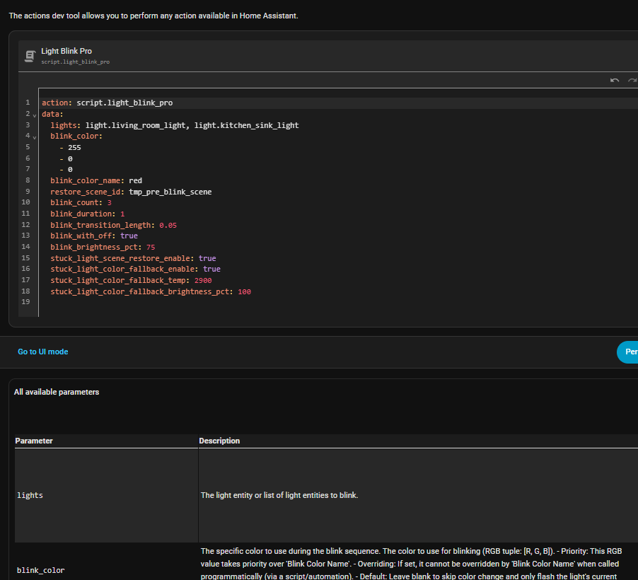

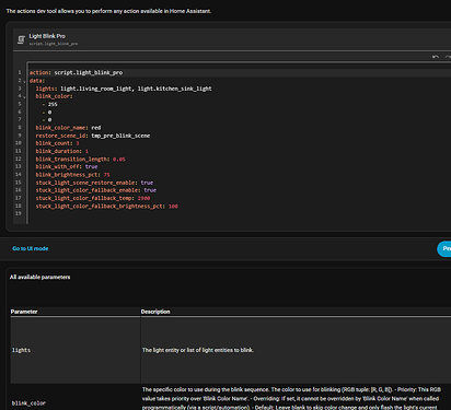

  • Programmatic Override: All configuration details (lights, count, color, duration, etc.) can be passed when calling the script from an automation or another script. This allows a single blueprint installation to handle countless unique scenarios.

Configuration Options:
Programatic Access:

any particular reason you have not made this into an automation (added triggers to the blueprint)?
It may be personal preference but Scripts just add more stuff to manage, more complexity, and more to forget how you set things up… an automation is an all-in-one, and also can be called just alike a script.
Yes, the reason is:
  • Programmatic Override: All configuration details (lights, count, color, duration, etc.) can be passed when calling the script from an automation or another script. This allows a singlehanded blueprint installation to handle countless unique scenarios.
For my use case, I have 5+ lights configured and several specific settings in my default script. It’s much cleaner to setup several very simple 2 line automations that only need to trigger on something, then pass a variable like light color, rather than creat that full blueprint several times.
