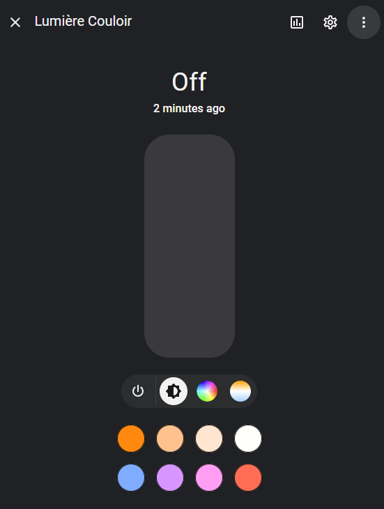

I just want the bulb to take the color I choose on the color picker.

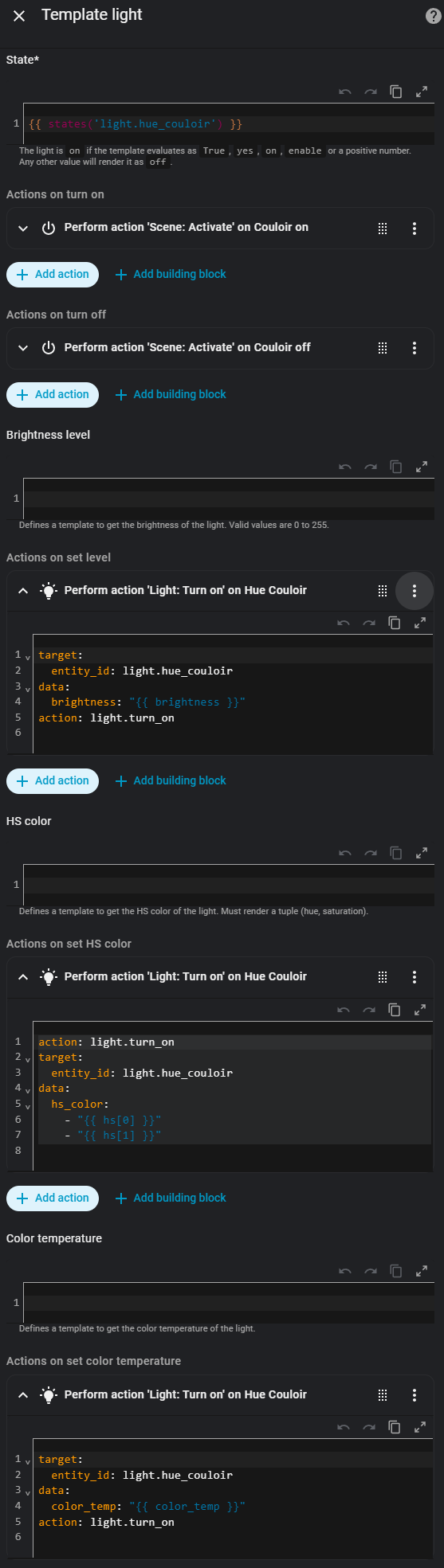

I succeeded with:
action: light.turn_on
entity_id: light.hue_couloir
hs_color:
- "{{ hs[0] }}"
- "{{ hs[1] }}"
I created this:
With these parameters:
Perhaps I didn’t express my request clearly, but in any case, it’s working now.
