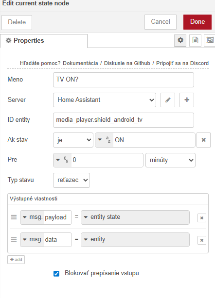

how to set light off when nvidia shield on?
Its rare that entities have capital letters for its state. More likely you are looking for on not ON.
I found out, it doesnt matter
That is not correct, it does matter. on is not equal to ON.

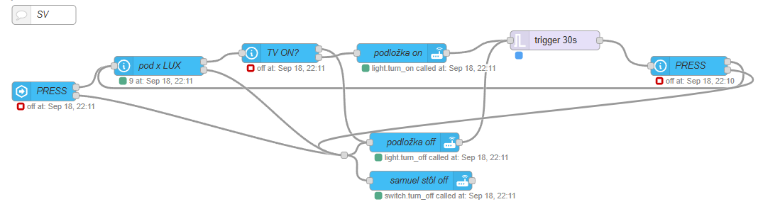

Thank You for info. Didnt know that. I thought I had ON OFF somewhere in the automation, but I went through it and everywhere had coincidentally on or off. Thank you
