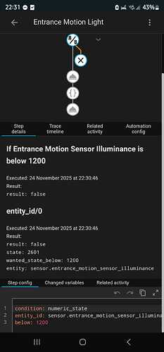

Edit: See below for a picture of the trace where it failed.
check your traces, it will tell you why it didnt continue on what step

Show the automation trace of a time when it did not come on as expected. I think something else is bugging you. For instance, if the automtion hngs in the wait for trigger, then because of the single execution the automation won’t run again. This will for instance happen when you turn the light off manually when there is still motion.

Your hunch is correct. Most motion sensors with built in lux sensors will only update the lux sensor value after they detect motion. Granted, it’s only a few milliseconds, but it’s a long enough delay that your automation has already run by that time.
Show where you added the delay. It should be part of your trigger, not part of the conditions.

Like @Edwin_D mentioned, looking at the automation traces will be a key part in determining why something did not behave as expected. Follow his advice and use the traces to troubleshoot.
This solved it. I had to play around with the milliseconds value but 810 works for me. I get the same result as the trace for any value below that.
