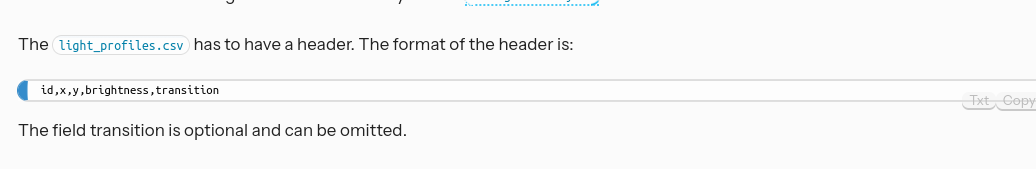

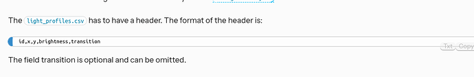

Where’s the header line?
Integrations - Light - Default turn-on values
Thanks. I added the header below but none of the profiles are working. Maybe the bulb type is incompatible with profiles? But I read the Orein bulbs do work with profiles.
profile,brightness,color_temp,gamma,transition
daylight,255,5000,1.0,0.3
evening_warm,180,3000,1.0,0.5
night_amber,25,2200,1.0,1.0
movie_dim,60,2700,1.0,1.5
focus_cool,255,6500,1.0,0.2
I haven’t really experimented with them much but, AFAIK, you have to use the header as provided in the screenshot above… you can’t make up your own headings or use different color formats. Light profiles are old and have not been updated in a long time.
