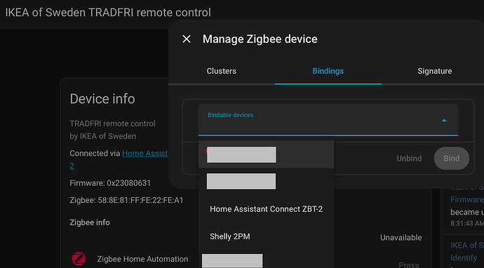

in the meantime, I have a 2PM relay and the ZBT-2 antenna just arrived, so I tried directly.
Indeed no device appear available when I try to bind the 2PM:
whereas the tradfri remote have more options, basically all the lights I have currently paired:
