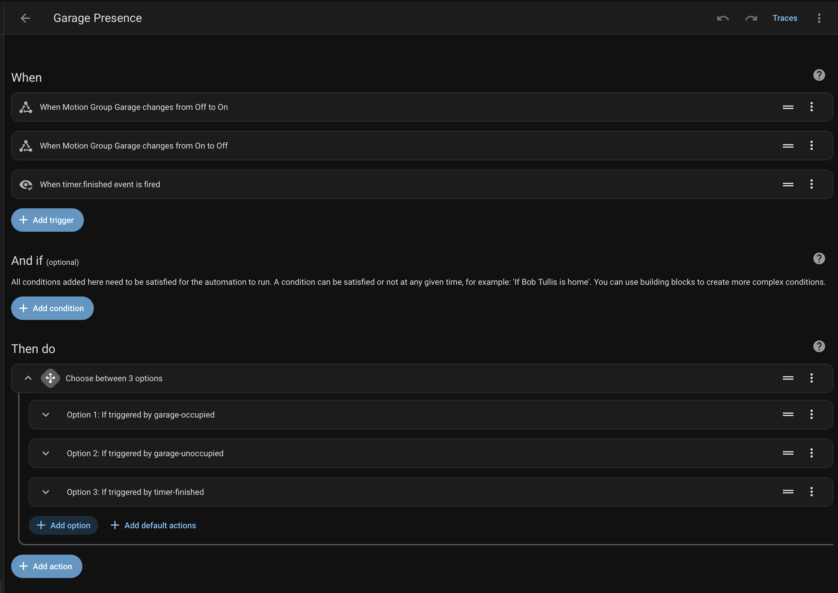

You can use a Timer Helper for where motion or presence detection momentarily loses track of someone present in an area. That is used to set a time limit for when motion/presence isn’t detected before it shuts off. Automation wait times will not persist through a rebooting of HA, but Timer Helpers will (and I reboot HA often, while I learn and grow with this home automation experiment/hobby).
I also use Lutron Aurora rotary dimmers in a few of the locations where I also use motion or presence detectors - bear in mind I haven’t bothered (yet?) to add a routine to override motion/presence detection if the lights are manually turned on (just don’t have the need - yet ). That said, here’s the automation I use with a Timer Helper for my garage. . . if I’m under/behind something doing a repair, the lights will dim to let me know I have 4 minutes before the lights will time out.
alias: Garage Presence
description: ""
triggers:
  - trigger: state
    entity_id:
      - binary_sensor.motion_group_garage
    to: "on"
    from: "off"
  - trigger: state
    entity_id:
    to: "off"
    from: "on"
  - trigger: event
    event_type: timer.finished
    event_data:
      entity_id: timer.timer_garage_lights
conditions: []
actions:
  - choose:
      - conditions:
          - condition: trigger
            id:
              - garage-occupied
        sequence:
          - action: timer.cancel
            data: {}
          - action: light.turn_on
            metadata: {}
              brightness_pct: 100
              transition: 3
              entity_id: light.garage_lights_z2m
      - conditions:
            id:
              - garage-unoccupied
        sequence:
            metadata: {}
              floor_id: basement
              brightness_pct: 75
          - action: timer.start
              entity_id:
                - timer.timer_garage_lights
              duration: "0:04:10"
      - conditions:
            id:
              - timer-finished
        sequence:
          - action: light.turn_off
            metadata: {}
              transition: 3
            enabled: true
mode: single
