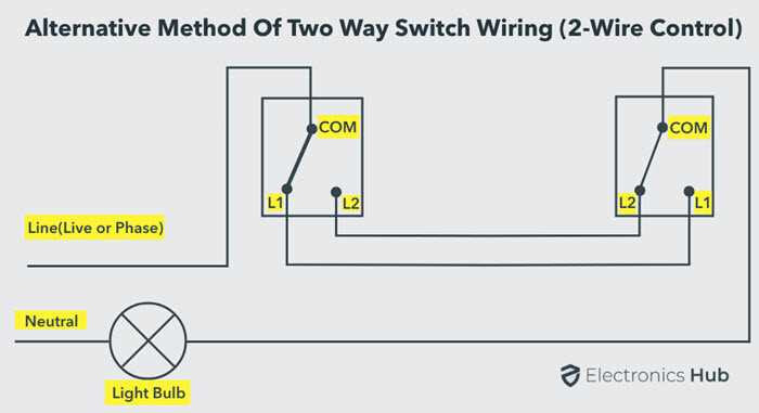

I’m looking for recommendations for light switches. My one weird request is that I want something that I can replace my existing switches with that continues to work even without WiFi. I’ve got lots of lights that are wired in a dual switch configuration so you can turn them off/on from two points, and I’d like to keep that working without any automation.
I believe they are something like this:

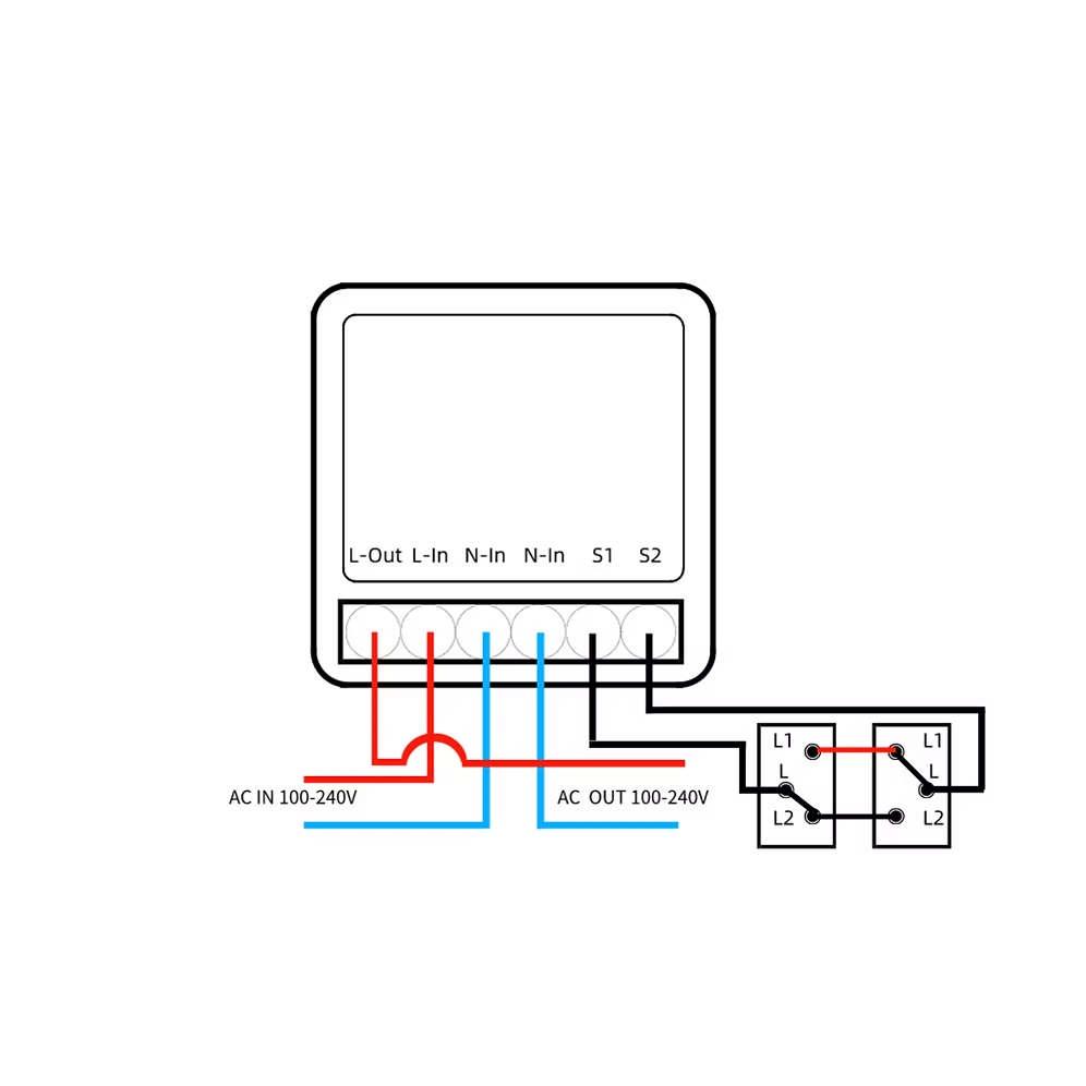

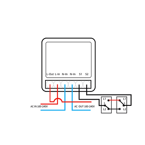

I’ve been mostly using Athom products - they work well for lots of things. With their relays, I could do something like this:
Unfortunately, their light switches don’t work in the same way. I could do it with a dumb switch and a relay, but I’d rather have a proper smart switch for more options.

Like you said, 2/3 way is better suited for relays

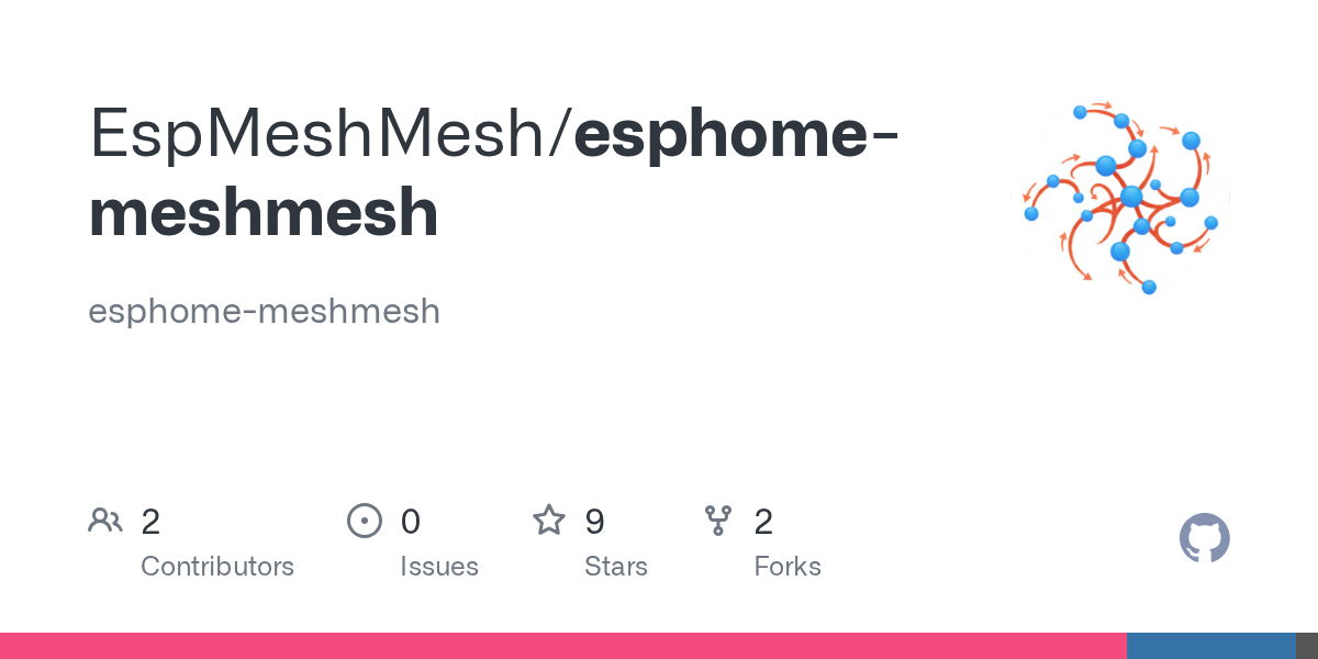

If you need 2 way switch that works without wifi, you could try flashing esphome with meshmesh component on your athom switches

Its starting to look like a relay and dumb switches (or even smart ones!)
is the way to go.
