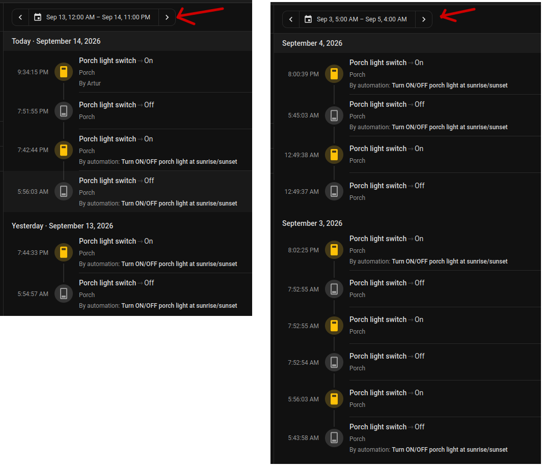

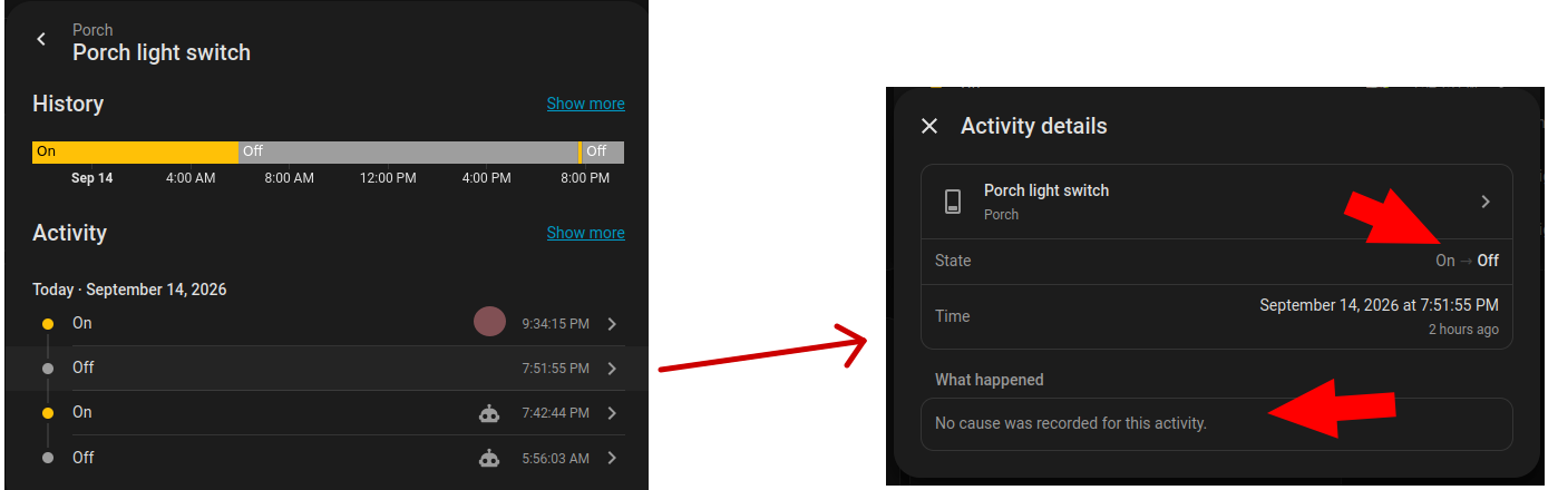

  1. Below I’m providing screenshots and I’m not sure how to deep digger to figure out why it turned off.
  2. It will run normally for days and then bam! the z-wave switch is turning off the light when no automation was triggered or the light switch was not pressed.
This happened today. It turned off but I don’t know why?

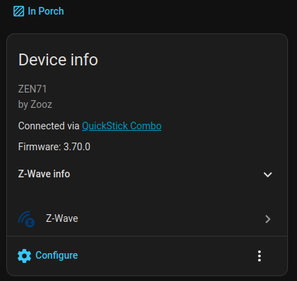

I’m running the Z-Wave integration and this is the firmware it’s showing for the device: 3.70

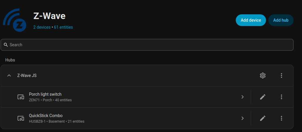

In my case I only have one Z-wave device and when I set it up I’m 100% sure I did not add it to any groups. I only added the switch and then setup an automation to turn it on/off. Here’s how my Z-wave integration looks:

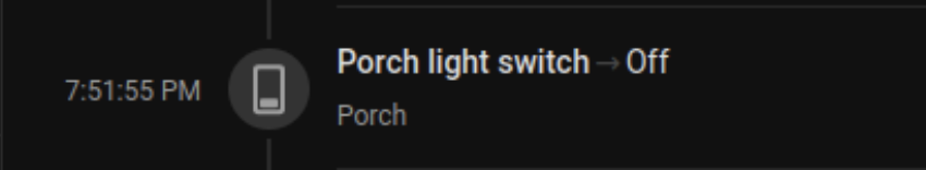

This looks like the change was outside of Home Assistant:
Nobody pushed the button?

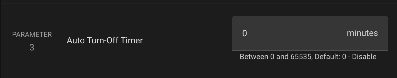

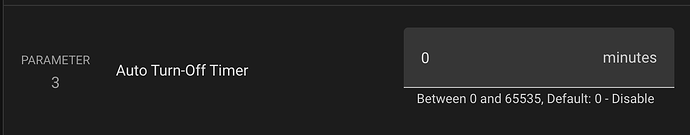

If you click on Configure (in your screenshot above) do you see this:
I’m talking about going into your ZWave coordinator software, probably ZWaveJS or ZWaveJS-UI and see if there is anything in Groups.
