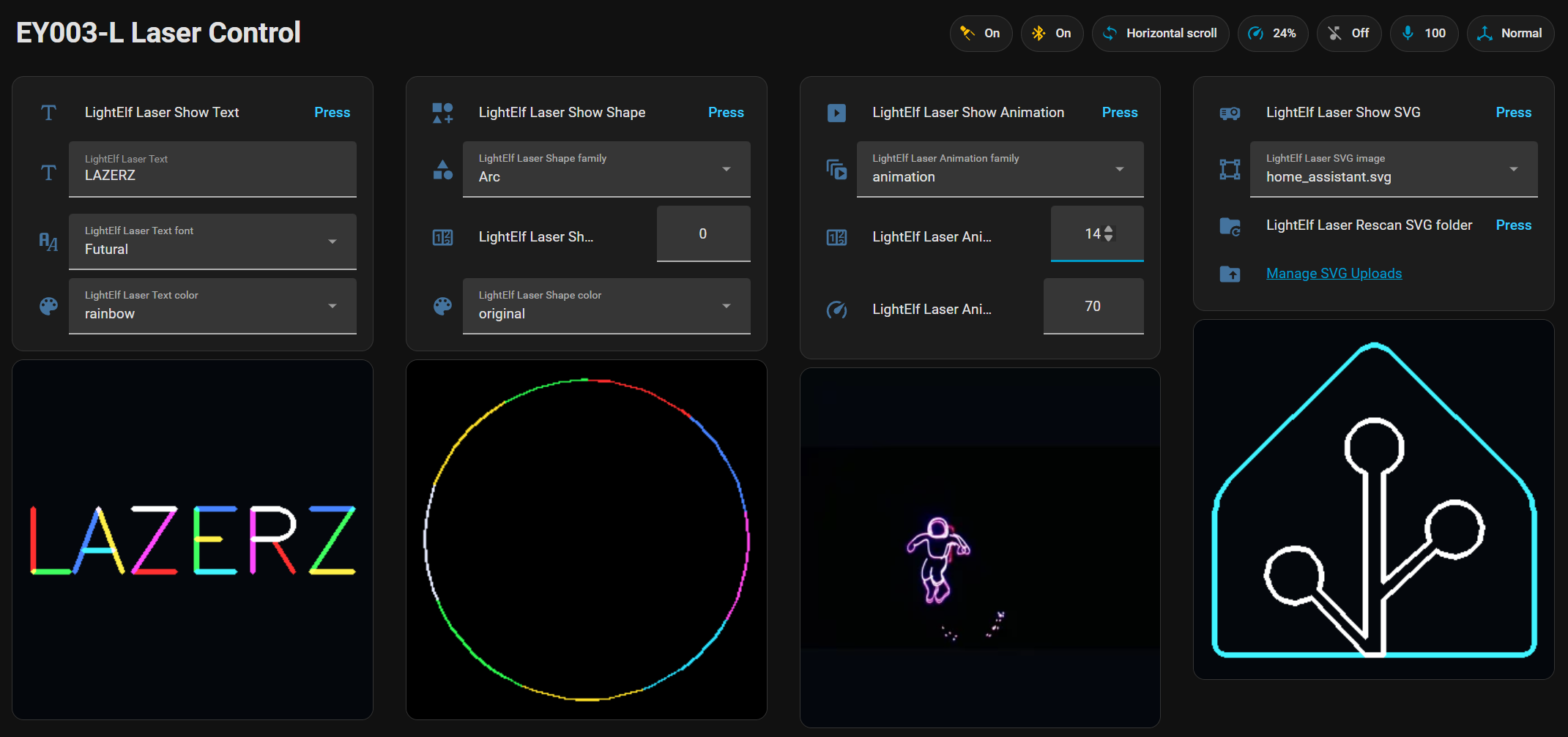

  • There are 200 built-in animations, the app provides no preview so you get four sets of 50 blank, unlabeled buttons to click on. I setup a global shutter camera on a clean wall, captured all 200 animations, looped and cleaned up, and now all animations have working previews. This component is a little big to download as it's coming with 200 WebP preview animations.
  • The app supports drawing pictures, instead we support uploading an SVG. These lasers are very limited, keep the SVG super simple, a couple examples are included and you can upload more through the config flow.
  • The app supports adding motion effect to drawn pictures, this integration extends that feature to support text and shapes too, this is a huge unlock over the stock application.

Control projector power, SVGs, text, built-in shapes, and firmware-native animations from Home Assistant, with previews before you light the wall.
Features
  • Local BLE control with live device-state polling.
  • SVG drawing with a native Home Assistant upload flow.
  • Vector text with bundled Hershey fonts, solid colors, or rainbow strokes.
  • Firmware scrolling text without host-side frame streaming.
  • Built-in static shapes with live previews.
  • Firmware-native animations with captured previews.
  • Sound-reactive mode that drives the active effect from the projector's onboard microphone, with an adjustable sensitivity.
  • Live transforms for your drawings โ€” spin, flip, tumble, cylinder-wrap, and more โ€” plus a static size control, all firmware-driven.
