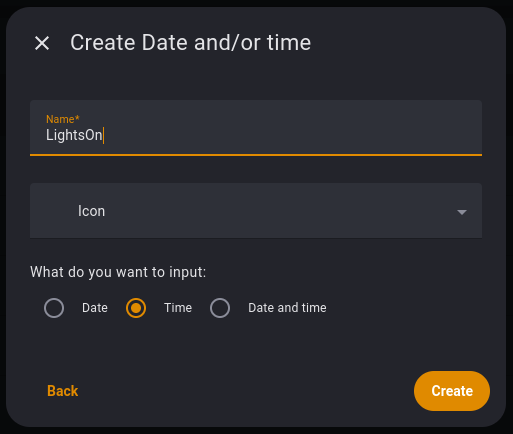

The HA analog to Domoticz’ variables are Helpers. “Date and/or Time” Helpers come in three types, make sure to select Time when you set up the Helpers, since that is what will suit your purposes.
You should end up with two entities input_dateime.lightson and input_dateime.lightsoffthat you can use in your Time triggers and conditions, and whose values can be modified through dashboard cards or scripts/automations.
