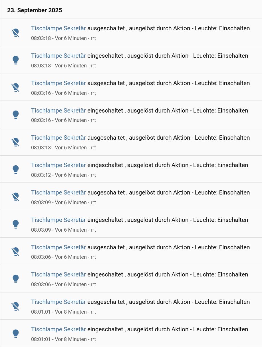

In the logbook, I can see that the light is turned on by action XY, and then almost immediately turned off again by the same action. So it doesn’t look like any automation or external trigger is turning it off — it seems like the same action is responsible for both turning it on and off.
Does anyone have an idea what could be causing this or how I could dig deeper to debug it?
Please share the logbook entry detailing the action?
Something is turning it back off. What action/service are you using?

I am experiencing the very same with Tuya TS0505B_1_1 and Tuya TS0505B_1 bulbs: If switched to ON the bulbs are switched back OFF again some milliseconds later. No automation is involved:
The bulbs are only controllable (can only be switched to ON) when using the slider for setting the brightness. ON through light.turn_on or through the switch on the light card does not work.

Edit: I have just rechecked through Developer Tools → States. If I hit the Light ON button the state of the bulb changes instantly to “on” for a brief moment but goes back to “off” instantly. Thus I don’t think it is a state issue.
