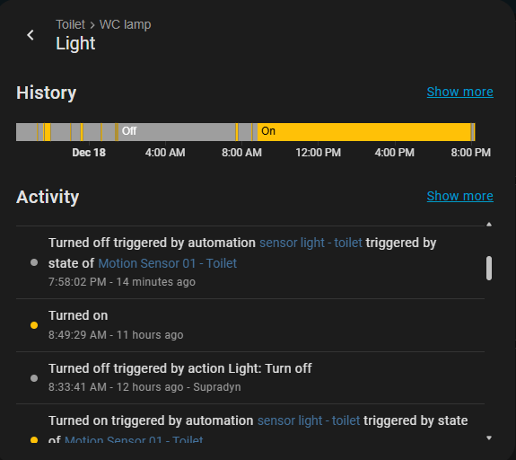

I’m seeing strange behavior with a few of my zigbee lights. When I leave in the morning, I switch all lights off from the Home Assistant app. They turn off correctly, but about 15 minutes later some lights turn themselves back on, usually at 1% brightness.
Home Assistant still shows them as off, even though they are physically on. The timeline: first the off-command, then—15 minutes later—a brightness update without anything triggering it. I don’t have any automation or scene that would cause this.
“turned on → some weird reason the lights turn on without anyone in the house
8:49:29 AM - 11 hours ago
turned off triggered by action Light: Turn off → me turning off the lights
8:33:41 AM - 12 hours ago - Supradyn”
Another odd symptom: once the lights are in this state, they stop reacting to automations altogether. My motion-based automations won’t switch them anymore. I have to manually toggle them in the app (or change brightness) before everything works again. After a few hours it feels like they enter some kind of unresponsive state until I “wake” them up.
