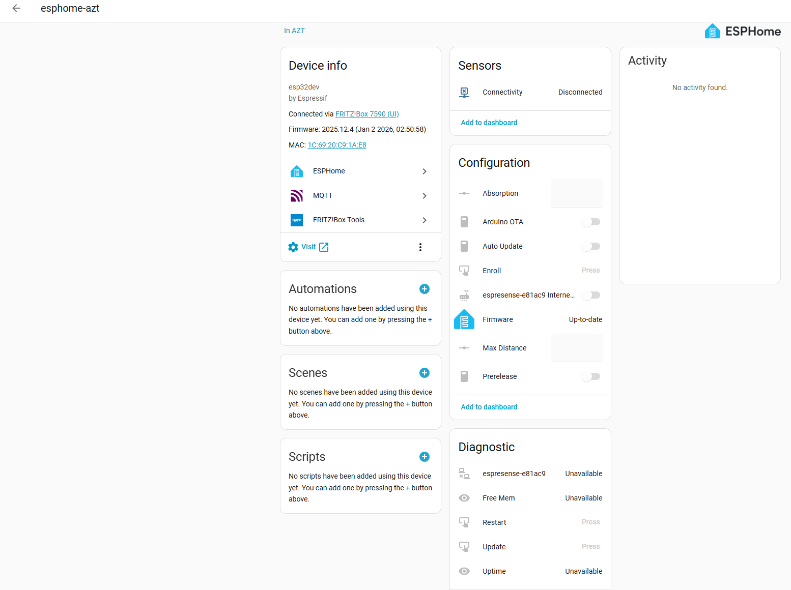

In Home Assistant I see a discovered device and add it to my integrations
I see some device information, sensors, configuration and diagnostic.
But connectivity is disconnected, configuration is grayed out and diagnostic is unavailable

As I wrote I let HA discover the device and added from there.
An tried to remove and add again also also restart HA but still the same issue.
