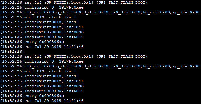

It is compiling, however I am getting this error in a loop on the device.
Oh, I have just found out that the git by hbast is for the t547 plus only, I have the β€œold classic” one. So that one won’t work
